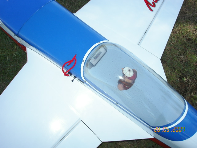

I'm wanting to put a 6V power system in my shotime 90 and need suggestions. All I've ever run are 4.8v NiCd and was looking for recommendations on a LiPo battery/regulator set up.

This is just my personal opinion and others may disagree but I would avoid using Li-po's with a regulator. This is because the regulator becomes an additional potential failure point. In my view, the simplest solution is usually the best and most reliable solution. If you want 6v, just get a 6V Ni-cad or NiMH battery pack. It's also less expensive.

As Chuck said, go with 6volt nicad or LOW internal impedence NiMh, or as I did, in my Katana, use 2, 4.8 volt nicads, 1, 1700Mah, the other is 1100Mah, just use 2 switches, & charge setups & plug the second one into a spare slot in the RX, it gives you redundency.
Works a treat, & you have 2 separate current paths, through 2 separate switches, the weight is worth it. If you look carefully you can see the 2 switches, 1 has a red lead, & the test /charge/ bind socket.
See here. http://www.rcbatteryclinic.com/

If you've ever seen a plane crash due to a power failure, the dual battery and switch setup starts to look like a great idea.

That's how I lost my last Katana, battery was 3 years old, but tested fine, first flight of the day, just after take off, nuthin, down she went, I will never let that happen again.
I was lucky with this one, the 1700Mah pack is under the wing tube, in the fuselage, & now so is the 1100Mah pack, perfect balance.
And no worries with RX drop outs, due to low voltage.
