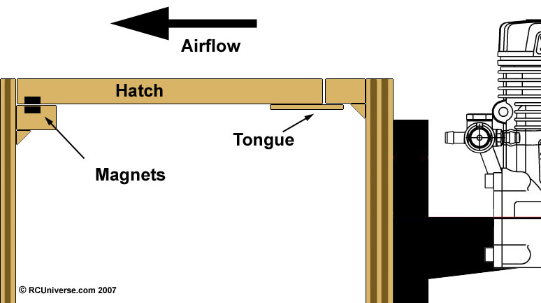

I read where folks are using the "rare earth" magnets for attaching hatches.
Does one just recess an area in the hatch and expoxy in place, then building a small ledge from behind the firewall for the plane attached mating magnet?
On my trainer... I put a lip on the aft end of the bottom of the hatch to slide under the front window.. and put servo mount screws in the corners by the firewall. But I'm trying to move into nicer construction techniques and looking for something cleaner. The plane is a 4* .40 and although plans call for glueing the hatch cover... I prefer removeable.

I'll add that if you can, to make your hatches with the magnet side towards the rear of the plane. Air will have a harder time trying to get under the magnet, losing your hatch.

I was going to say what deadeye said. Put a tab in the front of the hatch that will fit under a lip on the fuse, then use magnets to hold down the back

It's also worth considering to do what Minn and deadeye suggest only with a twist.
Hinge on one side and magnets on the other.
Airflow over fuselages often create areas of negative pressure and areas of positive pressure. Darn if it's a puzzle most times predicting where the pressures are going to help hold the hatch down and where they're going to try a pull them open. Put the hing on one side and since very few airplanes experience sideways airflow on the fuselage, the magnet on the other side probably won't see just negative or positive. (Unless the attitude in flight gets REALLY bad, and then you won't care if the hatch is found at the crash site or some distance away.)

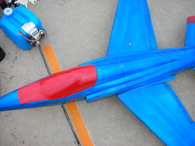

I was thinking about this the other day in a Turbine Application. So I looked it up and here we are.
Any reason not to give this a shot at 200MPH?

ORIGINAL: MinnFlyer
thanks for the pic... and daroc for the side mount suggestion.... I'll feel like i'm working on a ford model T. I was thinking about the little shelf for the bottom magnet and i'll give it a try.. getting close now !! ... down to covering... to bad I can't fly it naked since i build soooo much better than i cover ![&o]

Epoxy works for me. I dont know why it didnt for you. Maybe some skin oils or something like that? As for 200mph hatch covers, I've been thinking on that a bit and I guess you would have to make sure the hatch has good airflow over it. Just speculating but turbulance at high speed might buffet enough to blow it off. On the other hand, with the up wind side of the hatch pegged and a detent on the down wind side in addition to the the magnets, might just hold. There are some pretty strong magnets out there.
