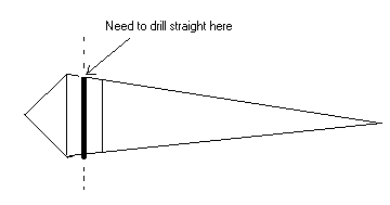

Hello,
I'm wondering if any of you know of a tool or have a special technique for drilling a straight hole near the bevel point of an aileron. Please see the diagram attached and tell me how I can do this so I don't screw things up
Thanks!
Thanks!

Hi,
Thanks for the reply, but I wasn't talking about drilling for hinges (you probably thought that because of my poor description of what I'm trying to do). I'm trying to drill a hole for the control horn (it's a Rocket City control horn). The problem is that the place I have to drill is at an angle, along with the surface (so I can't lay it "flat") - (please see picture that was attached to original post).
Do you have a drill press or bandsaw. If so it makes the following pretty easy. First take a small block of hardwood and drill a hole the size you want vertically through it. Now, mark off the angle on one side parallel with the hole and shave off the lower edge of the block to make the surface that the hole exits through have the same angle as the aileron surface. Now, just locate the block so the bottom of the hole is over the point you want to drill at. Drill through the block using the block as a drill guide.

If this is really an isosceles triangle, you can measure the angle at the trailing edge. The angle needed to drill will be 90 degrees minus 1/2 of this angle.
For example, if the angle at the trailing edge is 15 degrees then place the part flat on a flat surface. Place the drill at 90 degrees to this surface and rotate from the point of contact 7.5 degrees toward the trailing edge. Of course you have to have 90 degrees to all the other directions. The circular bubble would help with this.
Or simply raise the trailing edge 7.5 degrees with a support and drill at 90 degrees. You can check this by looking at the center line. It should be parallel to the work surface.

I saw your graphic, and understood the problem.
If it's a built-up wing, a jig of your own making is probably the way to go. (That's how Boeing does it!)
If it's a foam wing, I would suggest either:
1. Drill the holes in the "square" leading edge before you bevel it.
2. Attach the leading edge, then put the core back into the foam shucks, and drill it in the shuck. (Assuming they are straight, of course.)
As an extreme alternative, you could even use your incidence meter to jig up the aileron, clamp it in place, then use a drill press. Pattern guys always have good tips for this kind of thing. Mainly, just go slow. Sometimes, the answer is to simply walk away from the problem, relax, and think for a while.

Everyone,
Thanks for all of the great replies! They were extremely helpful. I resolved the problem in the following manner:
I purchased a dremel drill press (awesome little accessory for anyone who owns a dremel!). I put a 1/4" piece of wood-stock underneath the trailing edge of the aileron. By holding the aileron flat on the drill-press surface and moving the wood stock backwards and forwards, I was able to get the 90 degree drilling angle required. After I found the ideal place for the wood-stock to go, I taped it into place. The holes are straight and at exact 90 degree angles. Again - to everyone - thanks for all of your help!!
