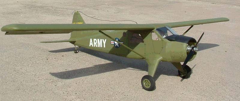

I know this has been covered here before but where is the best tutorial on making panel lines and rivits on solartex. I've just got to scale out my new Unionville Hobbies 8 ft Turbo Beaver. Tnx, Lanny

You guys sure do things the hard way...why don't you consider covering the aircraft, if it' a representation of an aluminum skinned airplane, with "aluminum" in the proper panel shapes, to begin with. Then all one would need to add is the rivets, screws, access panels, etc.
I wrote an article for MAN on this very subject last year...if you can't find it, I'll email you a copy.
i.e. the cowling and strut fairings are of aluminum
