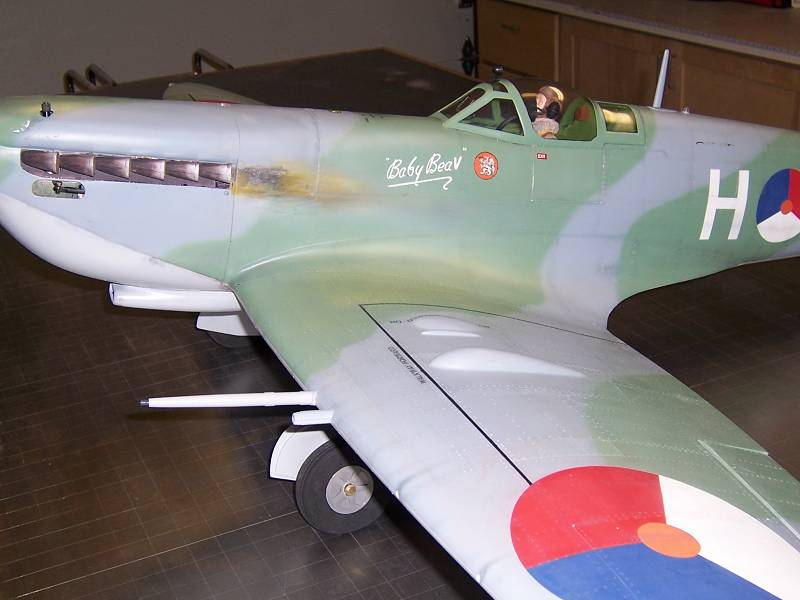

I used latex for my TF Spitfire. I really like the way it came out. I did it before I had the fore-mentioned gun and did it entirely with a Testors Aztec airbrush (about $100) and clear-coated it with rattle can satin waterbase Varithane Diamond polyurethane. I see Harbor has some airbrushes but I cannot comment on their quality.

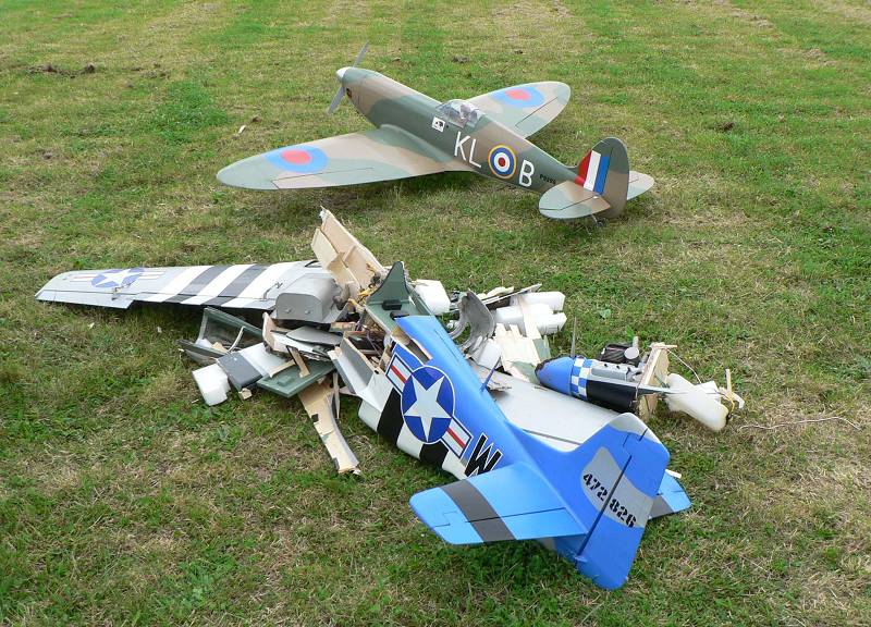

The TF P-51 shown here was painted with cheap spraycans. That was powered with a US 41 gasser.
The Spitfire was sprayed with acrylic house paint ex small testpots using a cheap Badger unit. Even the roundels were painted with that stuff - using 3M blue plastic tape as masking. Clear polyurethane was brushed over all that to provide a fuel resistant finish. The Spitfire is powered with an old OS 1.08 and has been flying for around 3 years and still holding up pretty well.

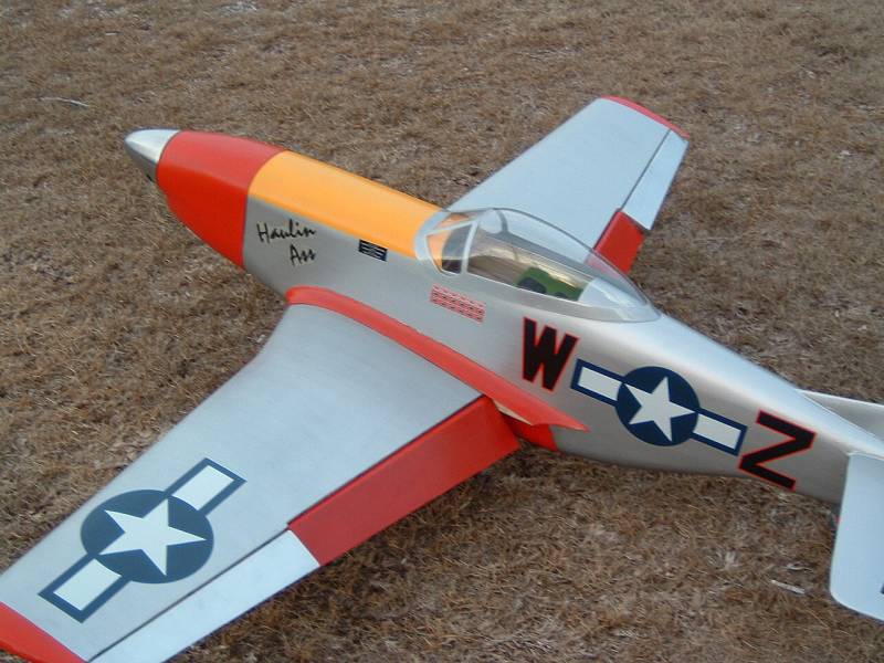

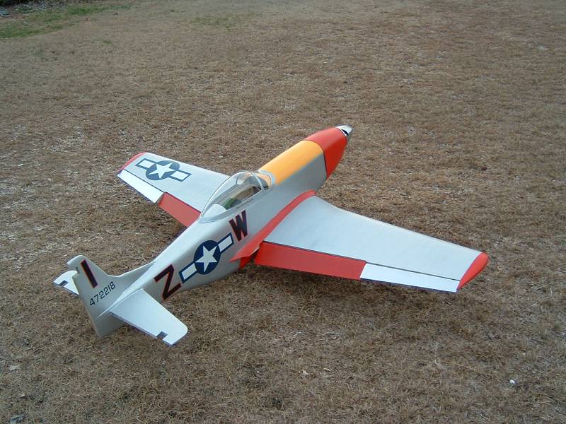

Well here is some of my progress, fuse is painted with Aluminum enamel from HD decals applied. Wings are still drying so could not make the picture. This was my first FG and paint project and other than alittle trouble with the tail it went fairly well. Thanks for all the ideas and help you guys passed on it really helps us first timers, I hope to be able to do that for someone else someday. Kevin.

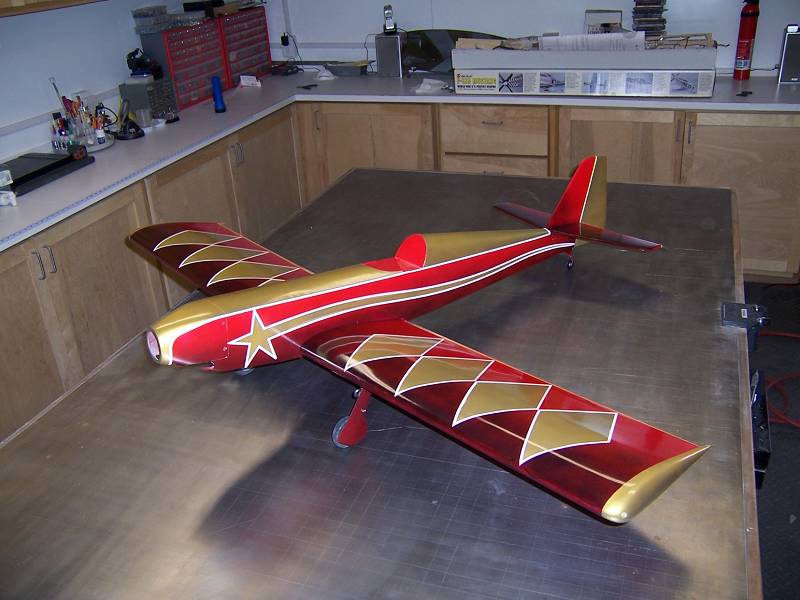

Hi Guys. I too want to take my modeling to the next level. I can build a kit and monokote it OK. But I want to try glassing and painting and building with foam and all that. I want to be able to make those glassy smooth sport planes I see pictures of. No one in my RC club builds anymore.
I've been reading Harry Higley's books. I'm building a Tower Fun 51 to try some new techniques. I’m going to sheet the wing and fiberglass it. Then try painting it. I have some questions on paint products I hope you gentlemen can answer. I want to save time by starting with products that work.
1. Where is a good source of fiberglass? $6 a square yard seems a bit high to me.
2. What do people use for a sealer. I purchased Sigs finishing resin. I’m going to try that. Is there a minwax product that works?
3. What is a good filler. Higley’s No Secrets recommends Dupont 30S. I don’t think they sell it here in California anymore. I can also try dope and baby powder. Anyway, I’d prefer a water based latex filler if there is one. What do you guys use? I’d like to brush on the filler.
4. For a primer I bought Nelson’s two part primer.
5. For paint I bought a pint of Nelson polyurethane Deep Red. I’d like to use a water based product.
6. I haven’t decided what to use yet for a clear gloss coat. I want to try making decals using ether an ink jet or color laser printer. The gloss can’t affect the decals.
When may garage warms up to 70 I’m going to start testing. I bought the Harbor Freight HPLV sprayer. I’ll try it with my cheap compressor first.
Any advice would be appreciated.

Making some more progress just need to coverite the tail surfaces flat Black and its on to final ass. Thanks to all who gave me guidance. Kevin.
