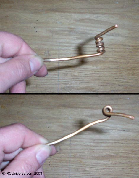

There have been many posts about bending brass tubing, and in the past, I have mentioned replacing it with copper tubing (available from most Auto Parts stores for about 50 cents a foot).
Well, a picture is worth a thousand words so here goes...
To prove my point, Last night I wrapped a piece of 1/8" copper tubing around a 5/23" landing gear wire just to show you how well this stuff bends.
I didn't do anything special; no heat, no filling with sand, or weed wacker line. I just held the gear wire in a vice, and wrapped the tubing around it.
(And yes, fuel will still flow through it)

Is there a danger with copper that it is more susceptible to fatigue crystallisation caused by vibration? I thought that this was the reason for using brass in preference...
Any metallurgists out there who can help?

I have been using copper for about 12 years with no ill effects. In fact, at least 2 of my planes that have copper tubing are over 9 years old.

I would think most vibration would be absorbed by the fuel tubing and the rubber tank plug. Not a metallurgist, but I would imagine it's not a problem in the short lengths and silicone cushioned installations we mght use.
Metal to metal connections might be another concern. (Remember when we had to make our own tanks for free-flight and control-line out of sheet brass?)

The only thing "wrong" with copper as opposed to brass is weight. But in the small amount we use on large planes that isn't a problem. If brass was of the same wall thickness we might feel differently about brass. The only reason to use brass IMO is for bushings or where you need an assembly to maintain it's "roundness" and "staightness". Copper is so much easier to use. Because is has a thicker wall it is much easier to silver solder as it won't burn through as will thin wall brass.
