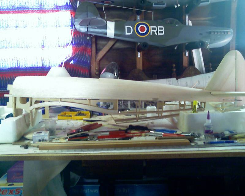

once you get them set, a good method I use is take a couple of plastic(the thick ones that look like the wire ones) hangars and use some plumbers pipe insulation on the bottom for padding and slip one over each wing side and hang the plane from the wings the pipe insulation pads the wings, they work well for hanging your plane from the ceiling,I hang a couple of planes that way off of exposed electrical conduit but hooks would work as well.
also for hangigng planes on the wall, metal shelf brackets work well pad the standards with the pipe foam and there adjustable and a 4" section will hold 3 planes easy and are adjustable for different sizes of wings and fuses.
I have a couple of wall hangars one by the T.V. work table and another over my main work bench.
