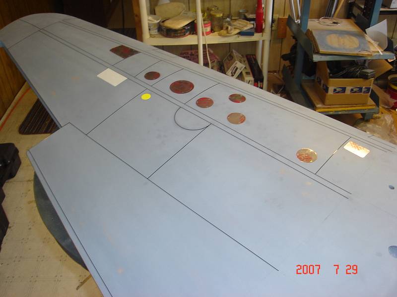

I am in the process of laying 1/64 chart tape on my p47. Some of the panel lines (actually look like small square hatches) have very tight rounded corners. I can't use the chart tape for these as the corners won't stay down. Like a rounded 90 degree corner.
The tape is great for straight lines and even curved lines.
Is there a solution for these tight corners?

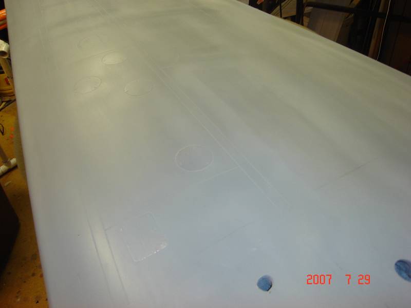

I used aluminium tape for any hatches etc. Just stick them down and paint over them. Use a piece of small tubing that has been sharpened to create rivirs or hatch screws.

For hatches with rounded corners, like Terry, I use aluminum tape. I cut the required shape and apply. If it's truely a panel and not a hatch, that could be a bit more difficult. To clean out the lines after removing the tape, I took an extra .05 alan wrench and ground a small hook into the end and used it as a scraper/scribe. If one were careful, you could use it to scribe the corners freehand.
