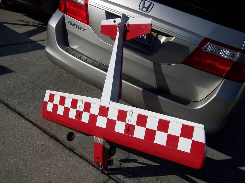

Just use water.. distilled is best.. let you slide the piece into position.. and you don't have the "soap" to deal with...Iron down before it completely dries up starting in the middle working your way out. I cut 2x2" checks on mine (4 star .40). 3 flights and no peeling yet. Just iron down well on the edges...
Mike

nice looking job kit builder,thanks for the info...
i`m building a 4*60 now with alot of mods...
