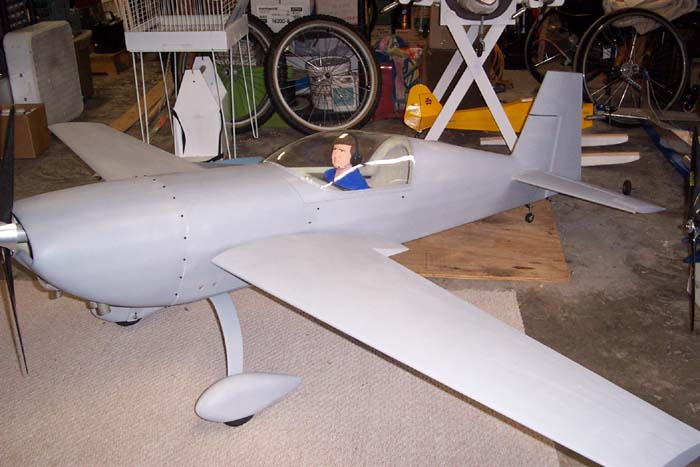

Well I'm finally going to start painting my new plane. It looks like this weekend will finally be warm enough to start spraying. I've never painted an entire plane before, just cowls and small stuff so this should be interesting. I'm pretty sure I have everything ready to go, but I'd like to hear from the experts. Any rookie mistakes that I can try to avoid?
The plane is all primed, sanded and smooth as silk (smooth as 400 grit paper anyway). I'm going to use House of Kolor Urethane paints and an Iwata gun and airbrush. Here's the before picture, hopefully have an after picture this weekend.
Ben

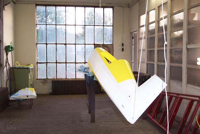

As crappy as this weekend turned out to be, I did get some painting done. Made pretty good progress. The two main colors (white/yellow) are on just about everything. Only have some yellow to put on the tailfeathers and airbrush a few black and silver trim. I'll put up a few pics tomorrow, I'm ready to pass out now.
Ben

Here's a couple of pics of yesterday's progress:

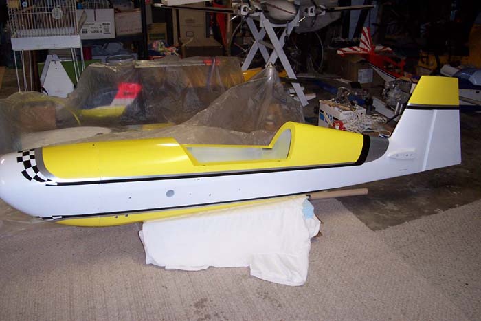

For some reason my other pics aren't showing up. Let's try this one:

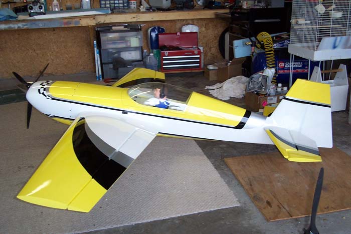

I'm really having a good time with this project. Once you've used automotive paints, all the hobby paints seem like such a waste of time. I finally finished all the trim (except the wings), and hopefully get the clear put on this weekend.
What do you guys think so far?
Ben
P.S. I hope Mike McConville doesn't mind me "borrowing" his trim scheme

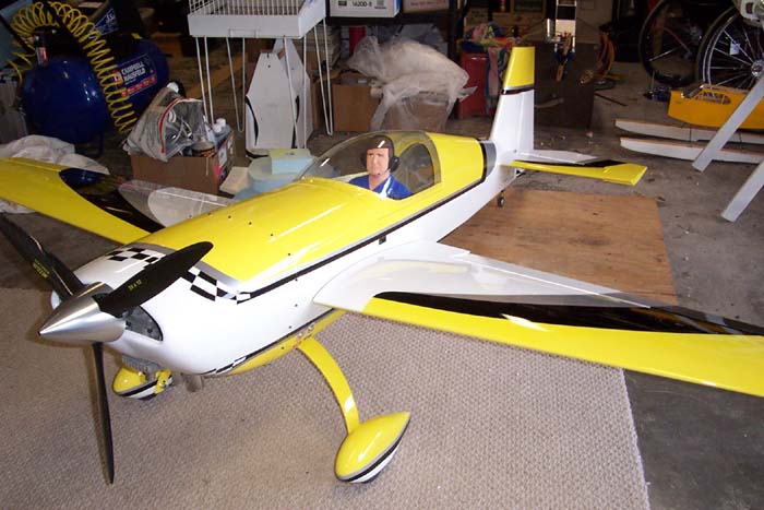

Finally finished painting!
Just a little final fiddling to do and a few days to let the clear have plenty of time to harden and we'll see how it flies. I don't have the numbers organized yet, but I estimate 2 pounds total for glassing/painting. That's about what I planned for (and about what I was able to shave off elsewhere). Soon as I get it all together we'll see what the total is.
I don't think anything less than ~1/3 scale would give the ability to offset the finish that I put on. I probably could have put a lighter glass job on, but it was my first effort. At this point I'll be happy just to see it fly!
Ben

Front view:
