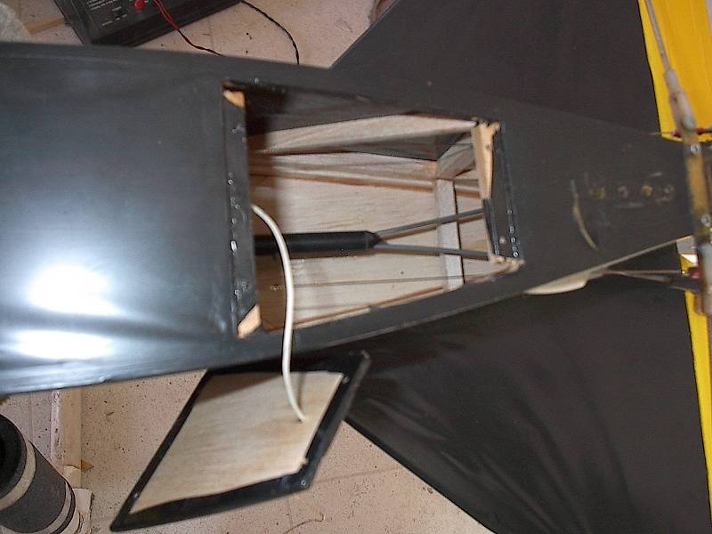

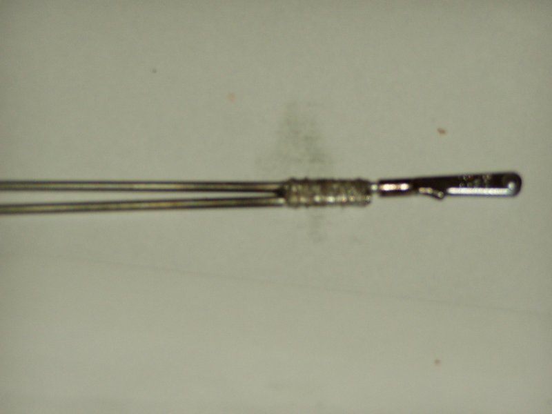

A pushrod that is forked at the back end of the plane can lead to trouble. It allows too much flex and can allow flutter. I lost a Goldberg Extra this way. A much better method is to run two full length pushrods and attach them near the servo. This is exactly what the DEPS that Jon mentions is. The DEPS is carbon fiber pushrods but the same thing can be done with standard steel pushrods. Use two full length 4-40 steel pushrods and run them as straight as possible and solder one to the other just short of the servo end clevis. Be sure to brace the pushrod guides. This is the way I set up all my old school pattern planes. Here's a picture of the pushrod I made yesterday.
Dave

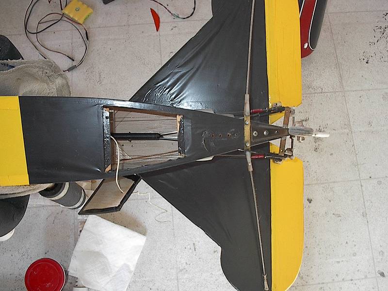

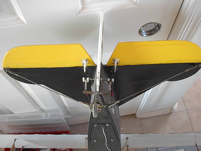

Back to that picture and A 1000 words thing. This is A really old scratch built plane I did about 10 or more years ago. There are A lot of ways to end up doing the same thing but this is the only plane I had handy with this old system in it. I have also made up Ys by soldering and bending 4-40 rod to custom fit A plane.
In this case I used A carbon Fiber arrow shaft, I used to have them in all sizes because I lived in the country and deer hunting came early for archers. During practice they tend to robin hood arrows and destroy them so I had my friends save them for me. The tip I used on this one you can buy, they even have kits to do this but free is better.
When using A Y I don't use the wire between the two elevator halfs. The Y can be used to trim each side as needed just like using two elevator servos and/or adjust for any warp.
Remember too that elevator rolling can be caused by too much elevator throw too, well, that and A few other things but this is A Y system.
