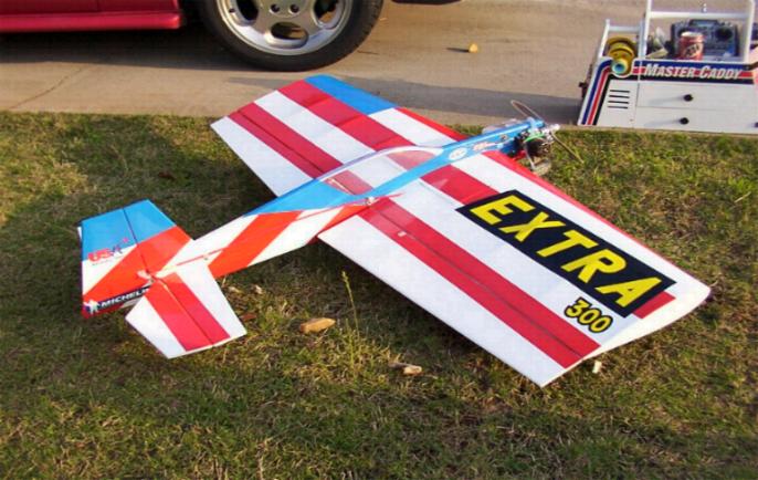

Old 05-19-2003 | 01:43 AM
Joined: Aug 2002
Posts: 1,551
From: Hampton, GA
Default How to make handcut lettering
okay here is one. The letters I drew out on the back of the sheet and handcut them.
I plan on putting the same thing on eacg side of the fuse and maybe a small logo of some sort on tail with same colors.
