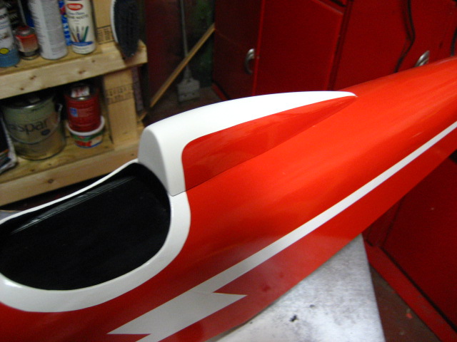

Cowboy, How did you get such nice crisp lines on your Hog paint scheme? I want to paint red over white solartex in a similar scheme on an Aeromaster bipe but can't seem to find a masking method that sticks well without sticking too well.

Well heres the thing,the white trim is not paint it is white color fabric, I cut it with a razor and straightedge,and this is why I need to clear over it.Awhile back I patched a trainer with some white 21st century fabric and the glowfuel turned the white fabric pink,I don't want my astrohog turning pink so this is why I wanna clear it,also I don't wanna see my trim blow off the plane.If u do want sharp lines go to the automotive shop and get some pinstripe and use that as your mask where your stripes will be then use paper and regular masking tape to cover the rest,start out with very light coats and allow dry time between coats.remember to that the thicker the pinstripe the less it will bend,so if you want to mask off something round use thinner pinstrip.Ok back to the clearcoat I was trying to stay with something in a rattlecan just to make it easy,now if I did go with something to spray from a gun what about clear gloss dope? It's cheap and fuelproof,any Ideas on that?

Here is the headrest I painted using pinstripe for masking the edge of the white trim.

The lines are more crisp then the pic is showing,they look kinda jagged in it but they are not.

Nice looking work Cowboy. My local club had a "big bird" fly-in yesterday and there were some beautiful scale planes brought down from Dallas. One in particular, a white/red trim Waco from Peppino plans caught my eye. I asked the builder how he did the gorgeous covering and he said the frame was sprayed lightly with Minwax "polycrylic clear" then polyester dress liner was ironed on. He then sprayed more of the polycrylic to fill the weave. The color coat was just Krylon and it looked awesome. He used Frisket paper to mask the complicated stuff. He then traced around the red trim with the that auto pinstriping tape as you mentioned. He then hand-brushed all the pinstriped areas with more polycrylic clear just so it wouldn't come off.
I asked how old the paint was and he said about 4 months. I then asked if he had ever had any problems with fuel or the polycrylic yellowing on light colors and he said "never". He mentioned he had been building planes at a museum scale level (and using polycrylic) for a long time. I kinda felt like maybe I've been overthinking this.
The secret to nice crisp lines in a paint scheme is the correct masking tape. Standard tan or blue "household" masking tape like 3M from the big box stores will allow the paint to creep under the edge and leave a "Ratty" parting line. Do your initial masking with 3M Fine Line tape in either green or blue. I prefer the blue because it's more flexable if you have curves in your color scheme. The tape isn't cheap and is usually stocked at any auto paint store. Then do the "rough" masking with the household paper masking tape. Overlap the rough mask onto the Fine line for complete masking coverage. Another lesson I've learned is do not use newspaper for masking. It leaves ink on the surface. I use the brown masking paper you find in various width rolls at the big box stores or any good paint supply store.
