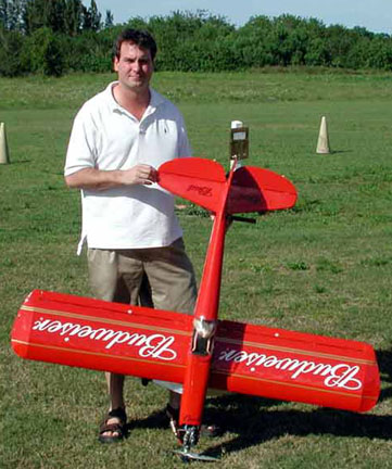

Got tired of spending countless hours building a plane getting the monokote just perfect and then falling short of my expectations because of a poor trim scheme. Although I don’t prefer ARFs some do have cool decals. I have found some decals online but big bucks and limited choices didn’t do it for me. My solution so far has been to print out water slide decals (purchased from Bel Inc. http://www.ceramicdecals.cc ) let dry and clear cote with top flite LusterKote. For larger and more durable graphics I have been sending them to WWW.fastsigns.com to have them cut out in vinyl. So far my results have been great but I’m still looking for a better way!!!

Although not the end all solution, I would suggest if you haven't gotten one, get a monokote striping cutter. I have one and with practice can make some pretty nice stripes. A little more effort and stipes become checks.
The other item I purchased recently is a desktop vinvl cutter from [url/]www.stika.com[/url]. Got it at the WRAM show for $200. I realize that $299 (website price) from them is a lot to spend but I have been having a ball cutting stuff....
