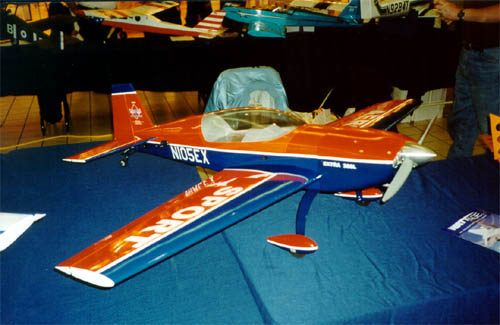

Old 03-26-2002 | 05:36 PM
My Feedback: (7)
Posts: 313
From: Wharton, NJ
Default How do you mount your cowls?
use nylon 4-40 screws tapped into the wood underneath (just CA the wood after tapping). Then dye the screws using RIT dye. At 10 ft the screws are invisible. Did this on my .60 extra for the cowling and canopy,,, can you see the screws???
