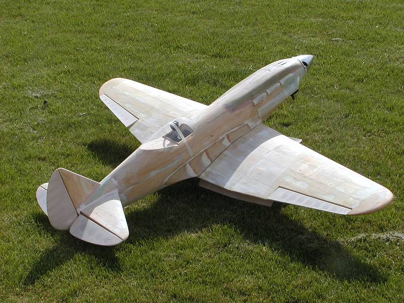

I will be attaching a canopy to a warbird before too long and I was wondering what are the ways that you guys do it? I have used RC 56 and tape with some success but not great sucess. I am looking for the type of glues and glueing methods, how some of you guys may even screw canopies in and down , and also your ways of finishing...ie, filling , blending , detailing etc. I say its never to late to learn a new way oof foing things.

There are as many ways to attach a canopy as there are ways of finishing a model. In your case I would attach the canopy with strips of light gass cloth or coverall or silk wetted out with West system epoxy or equilivant and blend it in to the contours of the fuselage. To get a good key to the canopy mask it up and sand the edges with 400 wet and dry paper to give the epoxy a key. I usually use this method when I glass the fuse and finish with paint. It helps if you wear gloves when handling the canopy to keep it fingerprint free

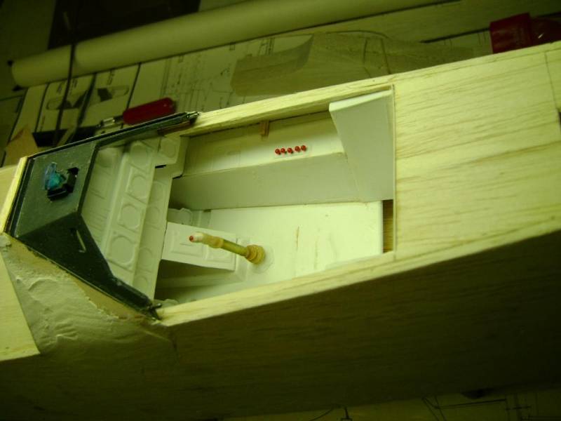

I build a frame out of 1/32" ply (easy to cut with sissors). Then fill the gap with tinned epoxy and fit the edge in the gap. I have done thesame for curved sections, but is alot harder todo. Takes longer fiting the edge to acurved area when both themounting surface and canopie are curved, but it can be done.

Jim, thanks for the idea, so as Iunderstand what you are saying, you would build a frame onto the fuse where the canopy would fit into? The canopy would butt right up to this canopy? Good idea and it makes for a nice blending surface.

I mask all of the canopy save for a 1/4" strip all around the edge. Sand the edge for a key and then glass to the fuse, fill and sand. and then paint.

Its has a grove you insert the canopie into. It allows you to do all the extra inside work before you attach the canopie.
