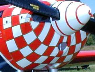

Default Flex Mask
Here's how I did it. Not difficult. A little time consuming but worth it. Paint the entire cowl 1/2 the lighter of the two checkerboard colors (in my case white). I then spayed on 1 heavy coat of Bob Dively liquid mask. In my opinion, the heavier the better even if you get a few runs. Draw the checkerboard pattern with a fine tip sharpie pen. A flexible drafting ruler available at arts and crafts stores helps here but is not necessary. Cut out on the lines using a #11 exacto. Pull out every other sqaure. Paint second color and let thoroughly dry. Peel out remaining flex mask. Please feel free to email me with spcific questions. cbk

Old 03-30-2002 | 01:10 AM
My Feedback: (64)
Posts: 807
Received 15 Likes on 13 Posts
From: farmington, CT
Default The other side
Another pic

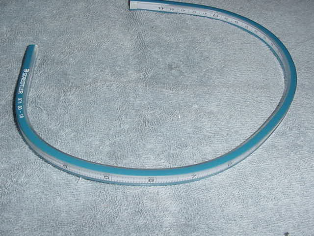

Default The flexible ruler
This helped alot. Made by a company called Staedtler. cbk

Old 03-30-2002 | 12:16 PM
Posts: 391
From: Elk Grove Village, IL
Default Checkerboards
CBK: Thanks for the pictures. Illustrates why it is necessary for careful masking of the cowl. None of the "squares" is the same size and shape. A way needs to be found to taper each of the checkers from front to back and side to side. [Answering an earlier post--no can't scan the article because I don't have the machinery to do so.] Some magazines have a service where they will photocopy articles, I know that R/C Report does. Email MAN and see if they have a similiar service. Their site is: www.modelairplanenews.com. There is usually a "contact us" section. Regards.

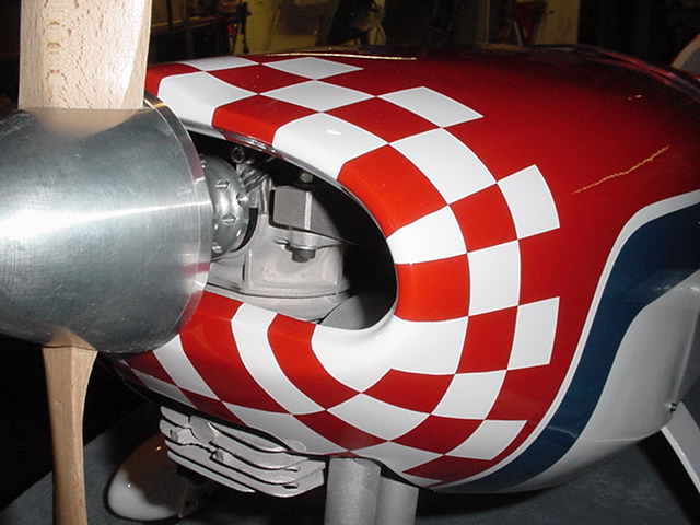

Posts: 647
From: Chelsea, MI
Default Painting Checkerboard on Cowl
Here is a pic of my PW Extra checkerboard on a 35% Carden. It was not hard - it just took time. Painted it white - masked the checkerboard off and painted it red. Really, not hard, just time consuming. I think it was worth the effort.
