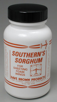

Anyone have DB Southern Sorghum. Sheeting foam wing's, I will PayPal you, please advise. I realize there are other method's, this work's best for me.

Not sold by Tower anymore but Dave still lists it on his site & you can order direct . Good STUFF ! MAX H.

Max - Thanks for the reply. Great, yes, but I just purchased the last two bottles they had. DB is not going to carry it anymore.

I have had very good luck with Liquid Nails Contact cement . Very much like the Sorghum & cleans up with water. Max H.

Max - Do you thin it with water, or brush it on out of the can ? Do the foam and the inside skin ? Does it adhere right away? I wrap the LE's. If no luck from these post's, by time the balsa get's here, I may try it. I have 2 bottles coming, I don't remember how much for one wing and stab. I may be OK for this plane, I am thinking about the near future.

I use a foam brush & don't thin it . Coat both the foam & wood & let dry .If going around a leading edge I lay the wood on a wet towel to soften the wood before bending. I think the smallest can you can buy is a quart but it really lasts . Good luck, MAX H.
