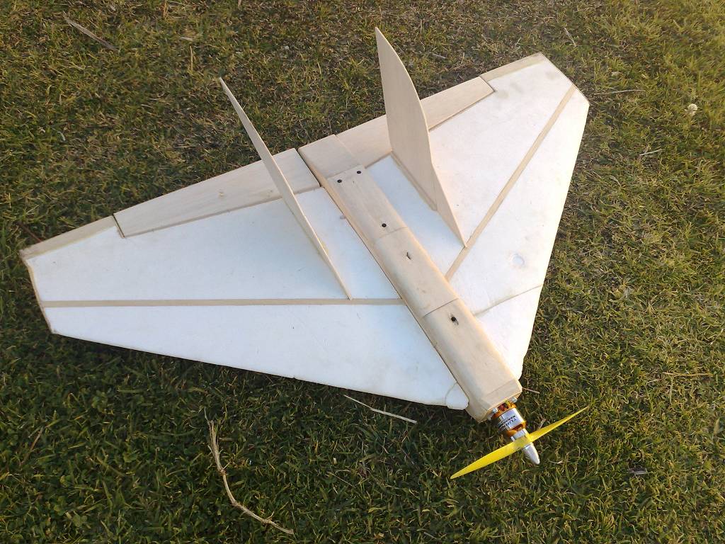

LDM, if the transmitter does not have a delta mix in it you will not get it to work properly. You need a V-Tail mixer advailable at good hobby shops.
Find them [link=http://www3.towerhobbies.com/cgi-bin/WTI0097P?FVSEARCH=V-tail+mixer&P=RF&search3=Go]HERE[/link] I have used the GWS ones before and they work well.
I use one in this model.
Cheers
