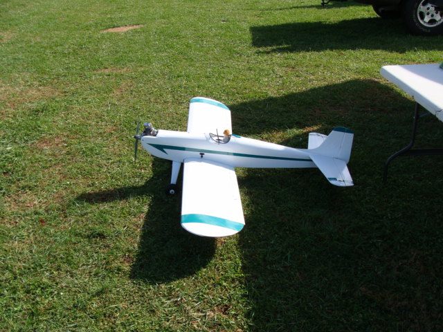

I used Titebond II and epoxy on my Astro Hog, no
complaints other than sanding,
Bob
