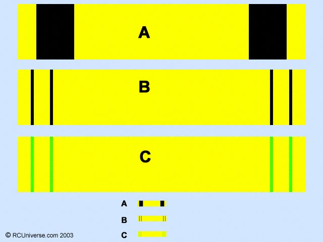

If the bottoms of your wings are yellow, I'd say try a wi-i-ide black stripe (front to back) near the wing tip. (Say 6" wide.)

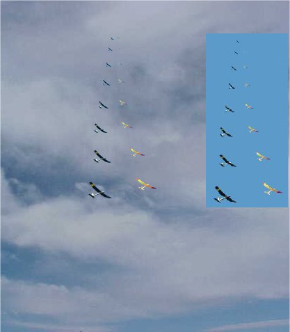

For flying under clouds I think the best color would be solid black under the wing and stab. I think that would give the best chance for keeping the plane visible. Someone generated a picture of a sailplane at various altitudes with two color schemes. One scheme was various (rainbow) colored wings and the other had black wings and stab. That was 'proof' to me that black was very, very helpful. Maybe someone has that image and can post it here. It is well worth looking at that picture. On your plane you could try black under the outer panels (tip area) and if you feel you need more then completely cover the bottom in black.
Followup: 'Tall Paul' included the image in his post below. It shows the black versus multi-color wings at various altitudes and sky colors. Very interesting.

Originally posted by Tall Paul
Depends on the day... clouds or a typical SoCal blue vault...
Dark on the bottom, light on the top..
How did you manage to get all those models to fly in formation like that?
-David C.

Originally posted by David Cutler
Wow!
-David C.
Wow!
-David C.
Each was piggybacked up....
