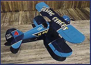

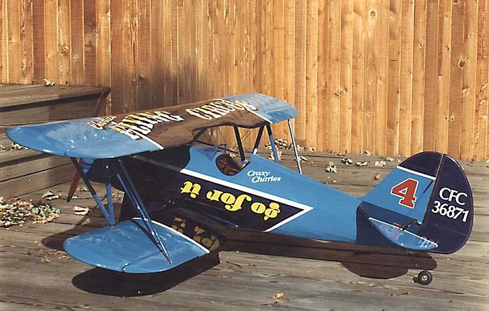

Here's my Monokote covered Waco.
Hand cut vinyl letters on top of the wing and machine/plotter cut small lettering in other areas like my AMA #. The red "4" is layered over a larger white 4, to give the outline. White lines are vinyl cut to width and length. Cowling and struts are painted. Flying wire equipped. Windshield frame is 1/32 ply with a glass cloth layer. Sports a full Pica cockpit and a leather seat. Covered this model many years ago.
