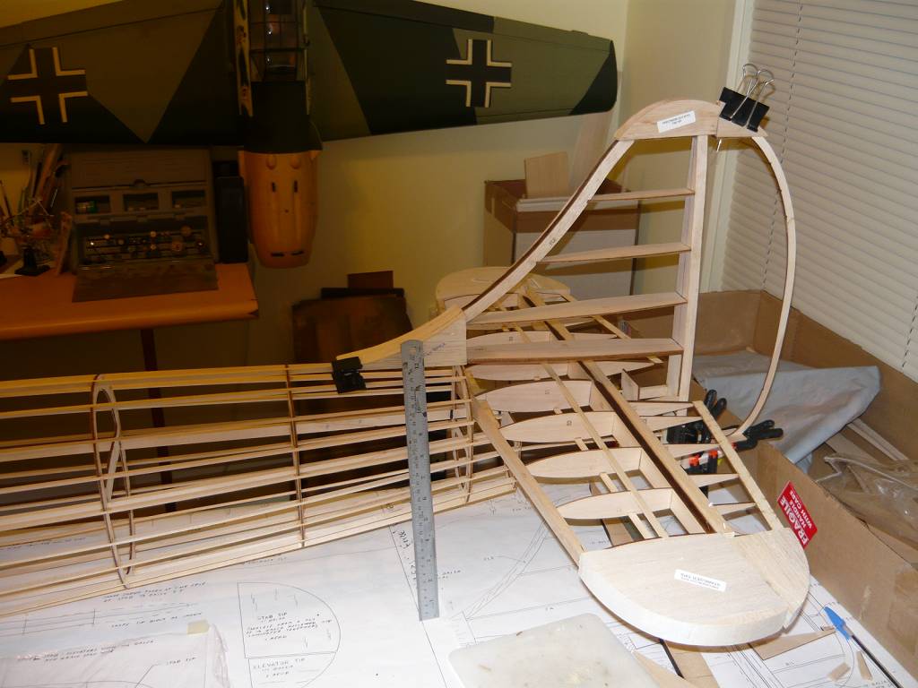

There are some photos somewhere else on this site but here are just a couple to 'whet' your whistle.. I've now sheeted the stab, elevators, fin and rudder and about to start on the wing..I'm hoping the tail wheel assembly will arrive in the next few days..
I'll take some more photos shortly and get them on board..
Bruce
