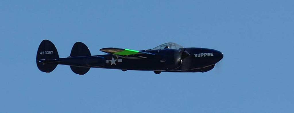

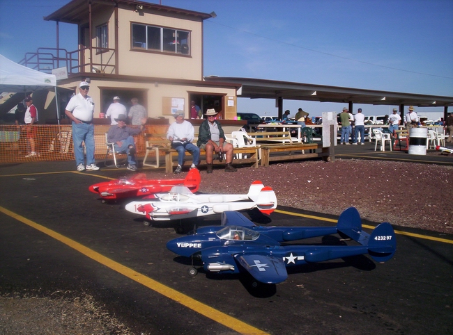

Naw its one of my two Wing Manufacturing kit P-38s. Both built for Warbird Pylon racing. The red on was lost to a midair in its second season and the blue one is alive and well although I have retired from racing. Travel is difficult anymore. I am the gympy one in the chair.
