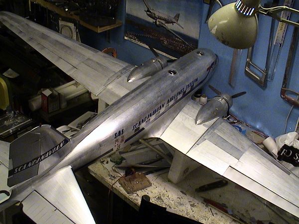

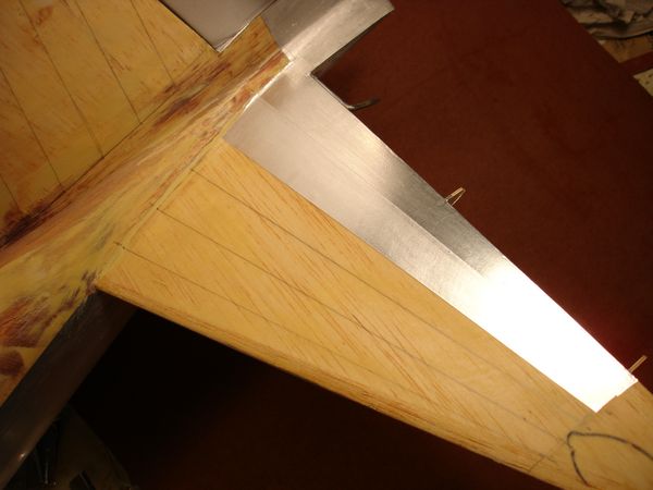

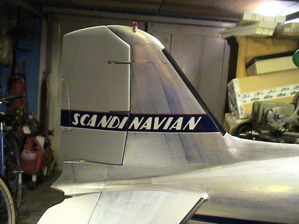

When I built my Marutaka DC-3 years ago I decided to lighten it in every possible way. Because light planes always fly better (Slower, more scale like)
That meant hollowing every balsa block and replacing every heavy item with lighter ones and only using small mini servos and the lightest covering available and still be "scale like".
I decided to first cover the fuselage with 25g glass-fiber weave and 24 hour laminating epoxy to have a though surface and then sand it to a smooth finish and cover it with small strips of Oracover chrome plastic film (wet sanded on a piece of glass).
Ca glue is fine for building (use it most of the time when I build ) but would not do when covering with glass-fiber.

Jaka,
Great looking model!
Isn't this stuff adheasive backed? "Oracal." One of the vinyls I use offers a "chrome" vinyl. Could they be the same?
Good idea the wet sanding. 400 or 600?

Hi!
Nice plane!
Four 2,5cc two strokes (OS LA .15) and 8x5, 9x3 or 9x4 APC or RAM props would be perfect for it!
I would replace the standard servos with Hs 85 servos on throttle and side rudder and use Hs 225 on elevator and ailerons.
I would also recommend using separate tanks (4oz) for each engine.
Personally I would not use Sullivan golden rods for throttle linkage, it's heave and flex! I would either use separate 10g servos (Like Hs 50 or 55) or using 1,5-2mm carbon fiber rods and bellcranks which will be lighter and give a more accurate movement. I use "Blue Bird" 9g servos for throttle in my DC-3.
I mostly build all my models with Ca glue. But Ca glue is not working with 25 glassfiber cloth. For covering a fuselage or wing with glassfiber use 24 hour epoxy, like West systems.This is the preferred method. Not Ca glue!!! Easiest to use though is polyester resin.
Oracover is a very good covering plastic film, called Ultracote in the US. I mostly use a covering iron to fasten it.

Hi!
My DC-3 fuselage is first covered with 25g glassfiber using professional 24 hour Epoxy resin...not the hobby stuff variety.- There is a huge difference!
The epoxy I use get glass hard after 18-24 hours,but is easily sanded.
After I covered the fuselage I spray painted it with Sikkens Autocryl 2 -part primer filler, then sanded it to a smooth uniform surface so that the wood grain would not be seen through the plastic covering. Then small stripes of Chrome Oracover was placed on a glas surface and wet sanded with 1200 grade wet/dry sandpaper.
Each strip was then placed on the fuselage and fastened with an iron.
On places with dubble curvature such as the rear most end on the plane and on the wing fillets , I used pieces of aluminium duct tape (first wet sanded on piece of glass).
Oracover fastens very good to a sanded glasfiber surface, soo you don't have to be anctious that plastic film loosens over time.
The only Oracover film that does not like to be strech repetadly is the "silver" variety.That's my experiance!
I would stronly advise you to put in a wing spar in the wing and not only rely on a glass covered surface. Using a thin spar is both stronger and lighter than a glassfiber covered wing and will also give a more ridged wing, which is good.
OS FS .20 will give plenty of power and is a good choice I think.
If you want I have scale, carbon fiber, 3-blade, "Hamilton standard" typ props for the OS .20 and .26. which will perform equall or better than the best 2-bladed props ( RAM or APC.
It's a very common misstake by newcomers to twin engined planes to over motorize them! Saying: "Better to have much power than too little...I could always throttle down" Sorry to say but saying so only reveals how little they know about twin engine flying and how to build.
It's much better to use as small engines as possible and build as light as you can. That way ,if everything works out as you have planned, you will have a smoth, easily flown airplane that behaves like the full scale plane in the air, not like a pattern plane!
