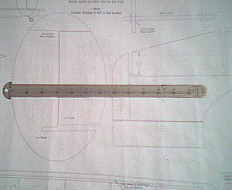

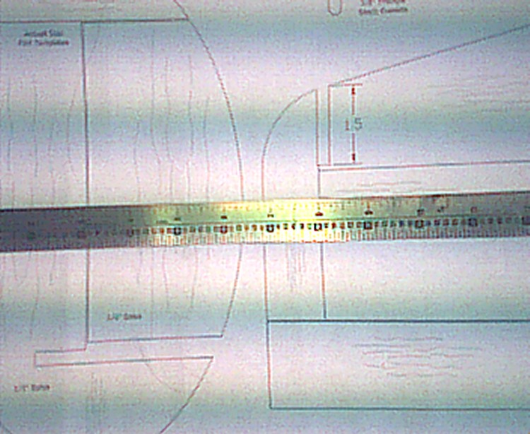

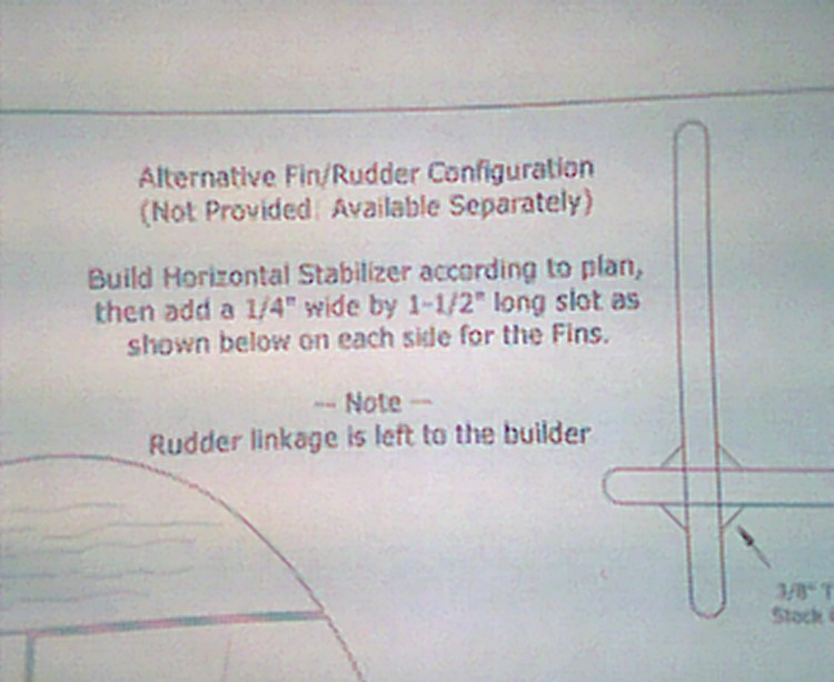

Yeah, that twin rudder setup looks good on this plane, doesn't it. Let's see, a built-up sheeted stabilizer to increase strength/stiffness, some sort of linkage to join the rudder surfaces... I'll consider it.
Questions- the original rudder is swept back, I assume to add coupling for some reason. So would building the rudders vertical help or hurt flight characteristics? How about size of the control surfaces. I generally can't get enough rudder, so would making them similar in size to the original be too much? I assume that locating them more in-line with the prop wash would only help performance...

The rudder is big enough as drawn, but some more wont hurt. It has been said more than once that there is no such thing as too much rudder on a twin.
You could leave the bottom of the rudder hinge line as drawn and run it vertical instead of having the angle to the rear. Changing the trailing edge to vertial instead of swept would still give you a little increase in rudder area, but a greater change in the fixed/movable ratio giving effectively a greater enlargement than actual.
You could also extend the trailing edge of the rudder, but you'd have to cut an angle in it for elevator clearance.
Finally, you could leave it as drawn. The airplane is a great flier just the way it's designed.

Apologies, sir. The twin rudder optin was not on the Twin-Air 25 plan, it was instead on the preliminary Twin-Air 15 plan. I am attaching three shots of that section of the plan. You will note it says the rudder linkage is "Left to the builder."

Ok now for the Twin-Tail discussion: The picture of the plane shown is indeed a Twin-Air .25 and not the .45 and the plans segment Bill showed is from the Twin-Air .15. Of the four Twin-Airs, only the .15 prototype had drawings for the twin-tail.

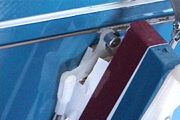

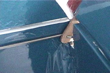

I'm attaching two pictures of the linkage used on the twin-tail Twin-Air .25.
To describe the linkage: there is a phenolic arm glued into each rudder in-line with the fin. On one end is a 'Z' bend and the other has a clevis for adjustments. Comming from the servo in the fuse is a control rod to a 90-degree bellcrank. The bellcrank is connected to a short control rod with an 'L' bend and a wheel collar. The 'L' bend goes into the bellcrank and the other end is soldered to the control rod that goes from rudder to rudder.
If there is enough interest in a twin-tail option for the Twin-Air and we can agree on a solid design (with linkages) I'd be more than happy to include it in the kit.

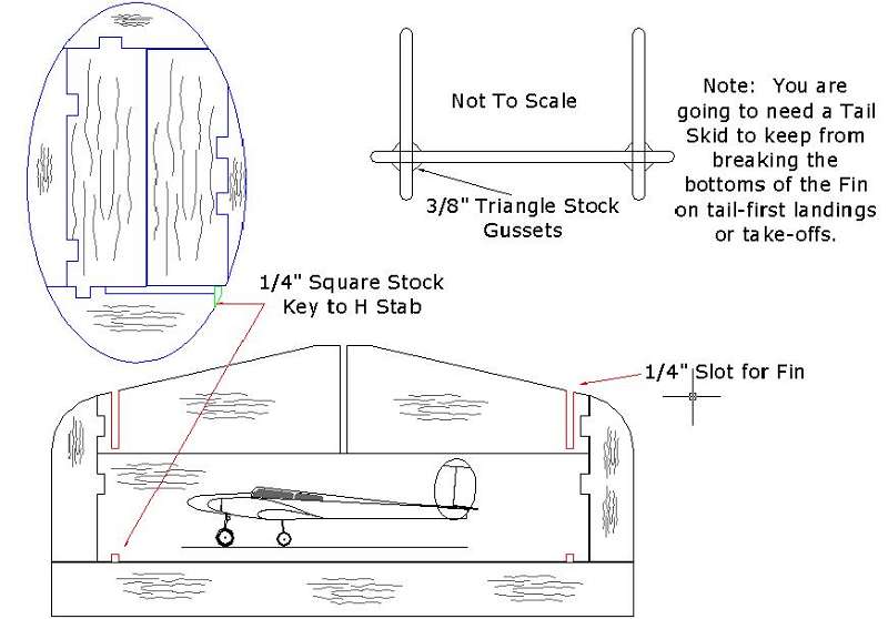

Here's a first shot at a Twin-Tail for the Twin-Air .45. We still need a linkage.

I don't know if there is interest by others, but if you are willing to work with me a little on this I will definitely give it a shot! (I am sure there are other Twin-Air builders watching this thread closely, right? ...right? Where are you guys?)
BTW I caught the Bill's incidence "error" but was afraid to mention it. I had my hands full with the ackerman and dihedral debates!
I was able to sort out your linkage setup from the photos and description and it looks quite simple. And I see you have the control hookup on the rudders in-line with the hinge lines to keep the control surfaces parallel as they are cycled. Some questions-
I assume that you have flown the plane in the pic. Does the control rod positioned just in front of the elevator hinge line disrupt airflow enough to make a noticable difference in the elevator response while in flight?
The plan pics for the 15 that Bill posted appear to put the back edges of the rudders in-line with the elevator hinge. Obviously, this is not the case for the 25 that was built since the rudder hinge line is even with the elevator hinge line (at the rear end of the fuse). Were the rudders simply pushed back?
The pics seem to show that the rudder surfaces extend below the elevator line, and the elevator ends are cut back to allow rudder travel. Is this correct? If so, then the rudders must be positioned at the very outer edge of the stab (not positioned at the line where the stab tips are glued to the forward part of the stab assembly as shown in the 15 plans)
And finally, what impact does the twin-tail have on flight characteristics on the 25 "prototype"?
Assuming that I decide to go for it- I can send you ACAD sketches before I start building anything if you are interested in taking a look...

Let's see if I can get to all of your questions. On the Twin-Air .25 prototype shown, the rudder line and elevator line are in-line. This necessitated trimming the ends of the elevator to account for the rudder's travel inboard. I never noticed any adverse problems by having the control rod for the rudders right next to the hinge line for the elevator. Though I suspect it accounted for a little whistling now and again.
As for the design posted here, I have moved the rudder inboard from the ends of the h. stab. This strengthens the joints between the fin and the stab. By doing this I also needed to change the rudder so that I did not lose so much elevator area. So the rudder hinge line moved forward and the rudder moved up above the stab. To keep the looks up, I also maintained the shape of the fin/rudder with a sub-fin under the stab -- which has its own benefits.
As for the rudder differential. That's a tough one. The math is right in that differential will help in turns by reducing drag on one rudder while increasing throw on the other. The practical problem is achieving differential in a model this size is going to cost you in weight and in complexity. Maybe its for the .60 size, but I'd go with parallel movement rudders on the .45.
John
