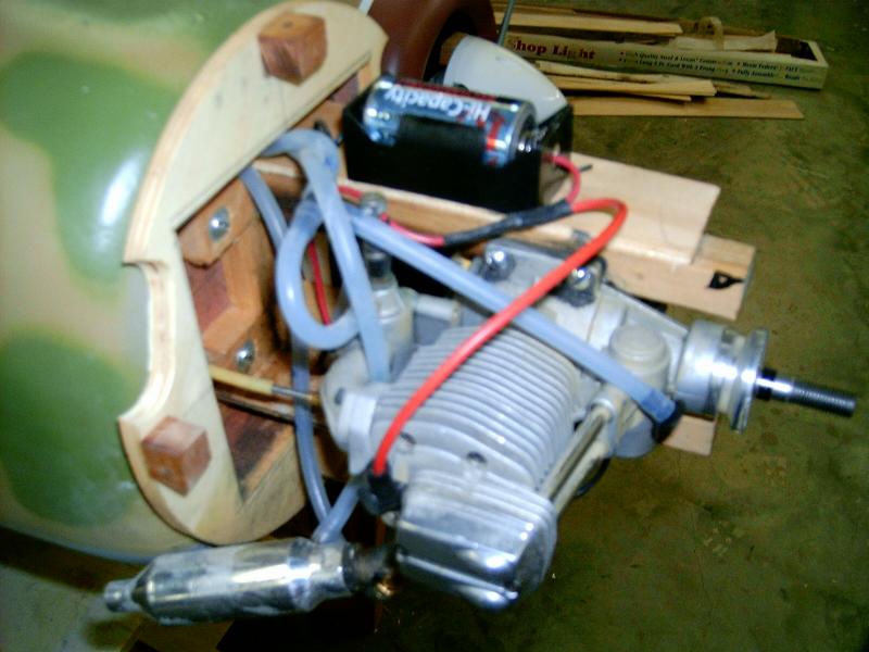

Here is a system that I have been using for a few years now. I tried some of the manufactured glow systems and found them lacking. I was told by one manufacture when I called with questions that if I had a big enough battery his would make it glow the whole flight. So I said I can do that myself and save about $40-$50.
This system is very reliable. It does not burn up glow plugs. I get about 40 minutes of continues glow with one charge. The engines have a very quick response. I have used this system on my Satio 150 inverted, 2-OS 91's inverted, Magnum 61's. All parts are available at your local Radio Shack. I have included a couple of pic's and a diagram of the set up. I have $12.00 in the whole set up minus the glow plug connector.( which you have to buy with whatever system you buy). The $12 does include battery which a bought system does not.

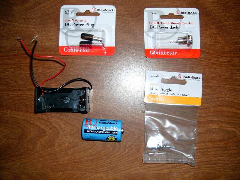

You Need:
part # 274-1569 Size M Coaxial DC Power Plug....... For charge Jack $2.49 2 pack
274-1563 Size M Panel Mount DC power Jack..... $1.99
275-634 SPST ToggleSwitch $2.99
C size Battery Holder $.99
Rechargeable 2000mah C Battery $7.49 2 pack

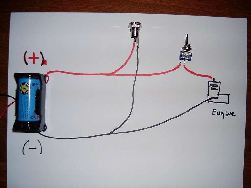

This is all you need to make the onboard glow set up. I do use 18 or 20 Gauge wire for this. I solder the heavier wire to the battery holder also. You have to have a solder gun to do this because it has to be done fast not to melt the plastic. ( just like the heavier wire) I have my 3 engine Sovia Marchetti S79 set up with 3 of these. It adds only 4 oz to the plane, each. The set up fits easily in an engine compartment. The battery holder has holes so it can be screwed to the firewall or engine mount. I have one complete set in each of the nacelles. I just turn them on at the beginning of each flight and leave it on.
Here are pic's of the parts.
A diagram of the set up .

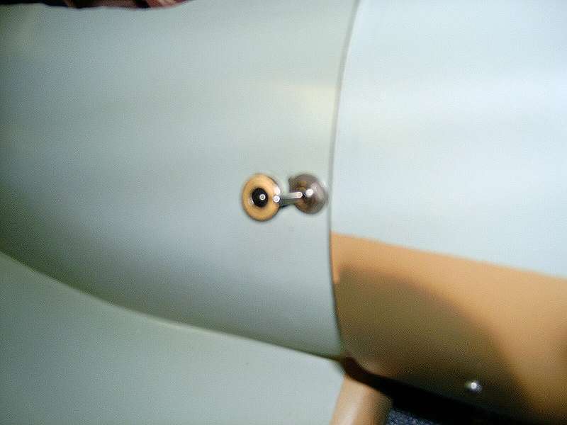

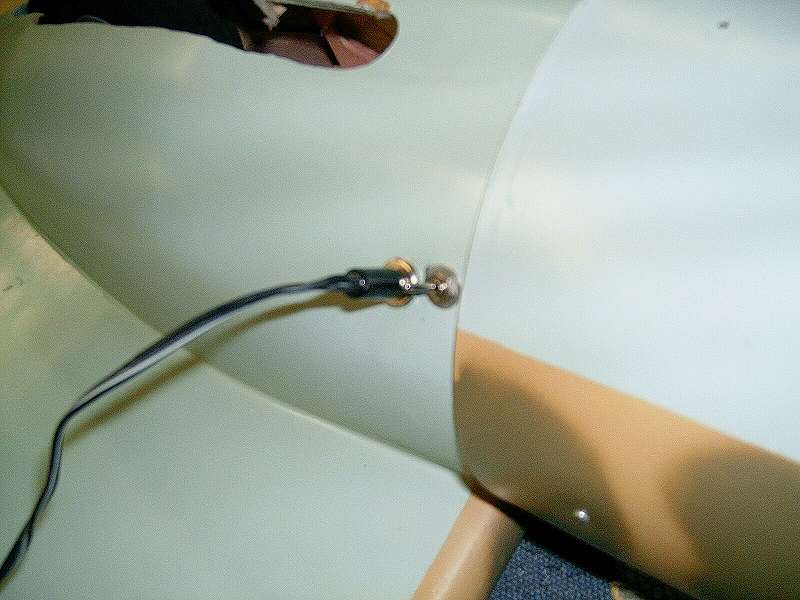

The Nacelle of my S 79 with the charge jack and switch.
Ty
I have had over 20 flights on the S79 without an engine cutting off.....

I have been using this set up for years without any problems. No clitches ever experienced by me. There is no spark with this system to cause interference during flight. With the set up I have described here you must use 1 battery per glow plug. I have tried it on 2 and you can get them both to glow. I even use 4 2000mah batteries in parallel and it would not make both glow.
This system is very basic. I don't fly for 40 minutes straight. That is how long you get with a fully charged 2000mah battery. I just use it for realiable engine runs. With my 3 engine Savoia the 2 outboard engines pull of of one center tank and the fuel flow is always changing. The rpms may vary 200- 300 RPMs at any one time. So I run these engines rich. The glow on all the time just makes sure the rich mixture does not cut off the engine.
If you see the need to spend the money on a of the shelf item, more power to you. I just don't see paying $40-$60 for something I can do for $12.....
