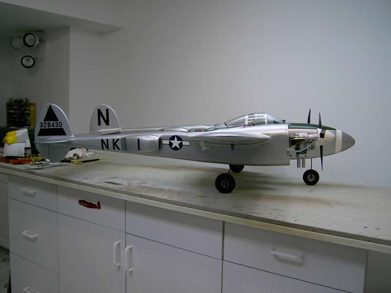

Thanks TLH101, will do. Here is some pictures, minus cowls...

I can add little to the above, except that ALWAYS do the vertical test. As posted above, do not lose and engine.
I did not see what engines you have with those three blade props. Unless the engines are .60's, I would suggest the first flight with two blade props for more efficiency. Make the take off run as long as possible, so that you have maximum air flow over the control surfaces at lift off. Plan on making the plane take off. Most do not automatically take off, but must be made to rotate.
This plane has very heavy wing loading, so make sure your use the rudders for turns and expect to use the elevator to tighten the turns.

Default RE: WING P-38
I AM THE "BUDDY" RAMFLYER WAS TAKKING ABOUT. I NOW HAVE 12 FLIGHTS ON MY BIRD. WHAT A SWEETHEART! WHAT THE GUYS ARE SAYING RE THE ROTATION IS RIGHT. I HAVE BEEN LOOKING AT A LOT OF REAL PHOTOS AND IF YOU LOOK CAREFULLY, YOU'LL SEE THE PLANS HAVE THE GEAR IN SCALE POSITION BUT NOT PROPERLY POSITIONED. WHAT I MEAN IS, ON A REAL 38 THE MAINS ARE ANGLED FORWARD. THE PLANS HAVE THEM STRAIGHT DOWN. I HAVE SINCE ANGLED MINE FORWARD AND I EXPECT A LOT EASIER ROTATION. MY BIRD IS 10.5 LBS, NO RETRACTS BUT I DO HAVE 24 OZ TOTAL FUEL ON BOARD AND I HAVE FOUND THAT IT LANDS LIKE A PATTERN PLANE. DONE LOTS OF TOUCH AND GOES. SET UP A CONSTAT RATE DECENT KEEPING A LITTLE POWER, JUST A LITTLE IN , OR SHE WILL SETTLE REAL FAST AND YOU'LL RUN OUT OF ELEVATOR EVEN W/ DUAL RATES. I USUALLY CARRY ABOUT 1,2 CLICKS ABOVE A LOW IDLE. PAY ATTENTION TO HOW THE PLANE TURNS. THIS IS A GOOD INDICATION AS TO THE HEALTH OF THE ENGINES. IF IT GETS HARD IN A DIRECTION, THROTTLE TO HALF, LET THEM RICHEN UP AND THEN THROTTLE BACK UP. YES RUDDER, JUST A TICKLE, IS GOOD. DON'T HOLD IT! ALSO, I HAVE A TAKE APART FUEL FILTER, MACHINED ALUMINUM, IN THE MUFFLER PRESSURE LINE. OPEN THIS UP AND PLACE A SMALL STEEL BALL FROM THE HAND PUMP OF A LIQUID SOAP DISPENSER IN THE DIRECTION THAT WILL HOLD PRESSURE IN THE TANK. THIS REALLY KEEPS THEM RUNNING SMOOTHLY. TRY IT. YOU DON'T WANT A REAL TIGHT SEAL. SOME LEAKAGE MUST OCCUR OR IT WILL OVER-PRESSURE. LET ME KNOW HOW IT GOES. WORKS LIKE A CHARM ON THIS SHIP AND OTHERS. I HAVE A FUNFLY NOT FOR SALE THAT WOULD DIE AFTER ABOUT 30 SPIN TURNS. THE CHECK VALVE STOPPED THAT. P-38BOB
