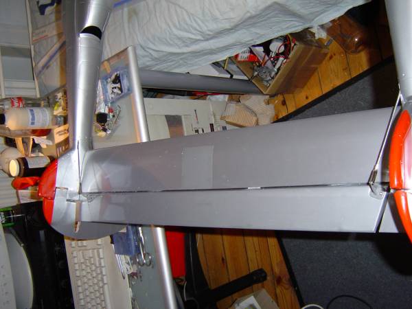

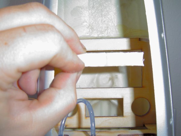

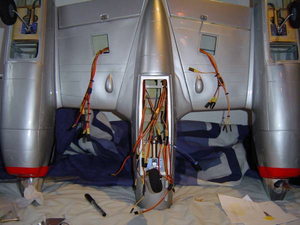

hehe.....well the acces through the engine bulkhead is
Well, during instalation of the rudders and elevator and servos I have run into small anoying things
There are only 6 pin hinges included with the kit, which is enough for the inboard flaps. But Im missing a further 8 more for both rudders.
I also had to remove some fiberglass in the booms so the elevator/rudder/throttle mini servos will fit.

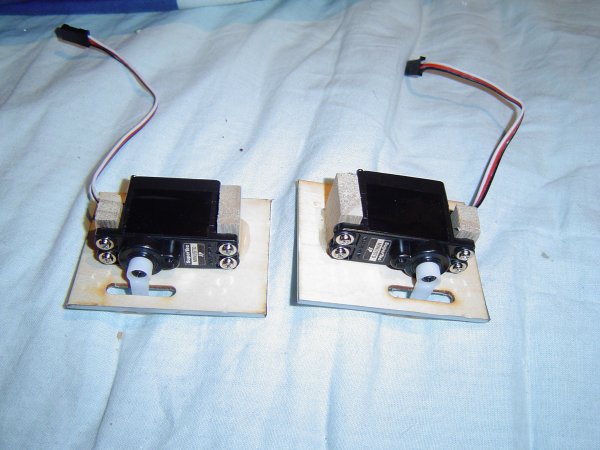

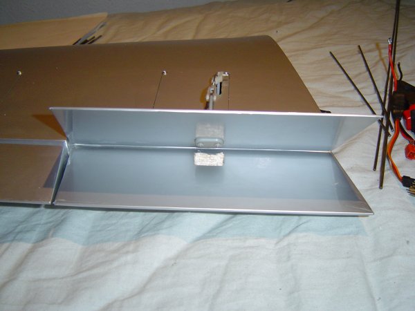

indboard split flap servos.
ID:	184315   Click image for larger version

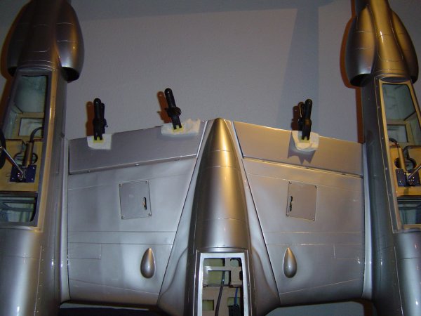

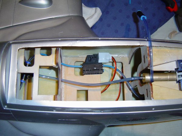

I had an unused electric pneumatic valve lying around......easier to install than the mechanical servo operated valve
Also installed the two outboard flap servos.
ID:	184371   Click image for larger version

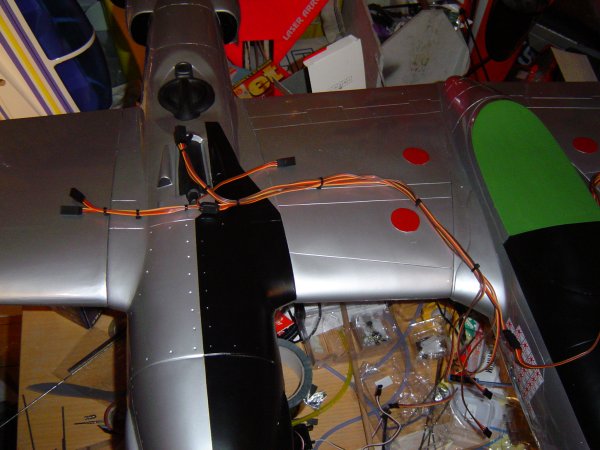

Also glued the stabilazer onto the booms, and installed one of the rudders. Will have to wait for more pin hinges until the other one can be installed too.

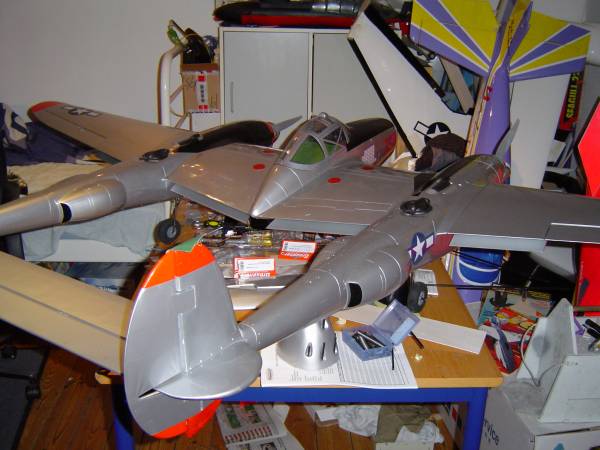

Thanks for all the great pictures, I can see many, many small changes between my older version and the new one, a lot of major stuff too, it looks like the quality still isn't very good though.

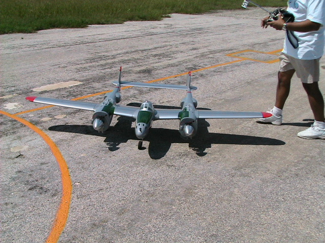

Hey I have the same problem with mine. Have no idea which retract gear to use from Robart.
Woud you help me givin me the part number from Robart do you use in yours?
Also want to know if you use Robostruts and Wheels from them. Mine fly really well but I cant make the gear to work and is a shame.
I´m attaching a picture.

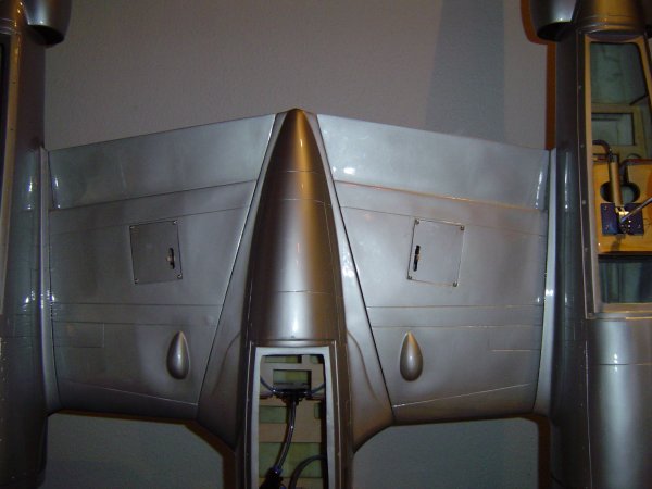

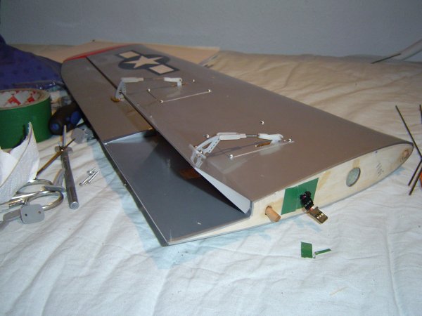

had to remove a little wood in the outboard flap so the plastic back plate would fit......

Can you mount the flap servos so they are semetrical so no reverser is needed?
Sam
Yes you can, but it will just look odd

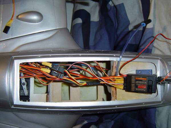

The inboard, and outboard flap servos are installed semetrical, in both sides.
Im using 2 Y leads, and 2 channels for the 4 flap servos.
Im also going to use a Y lead on the ailerons, and a Y lead on the 2 elevator servos.

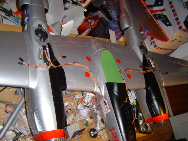

Inboard flaps glued in....and the wiring harness layed up [8D]

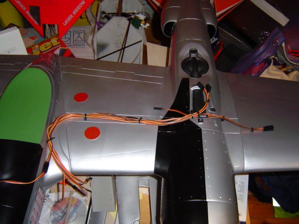

hey you got a nice looking bird there!, could I make a suggestion without insulting you?. here I go. I have been doing lowvoltage eletronics for 20 years now, not saying that you will have a problem but tiewraping servo wires is not the best idea and if you still decide to do so make them LOOSE! Whenever you tighten on a wire you drop the resistance value of the wire, this dose'nt nessesarly mean it wont work, but the wire is designed to work BEST at a certian resistance value. its kinda like putting regular oil in a porshe when it really needs synthetic! hope you take this in mind. (Blenderm skin Tape) the best stought in the world and very light! Have a great day! Chris
Old 10-22-2004 | 11:15 AM
  #68
SJN
Posts: 6,326
Received 7 Likes on 7 Posts
From: Copenhagen, DENMARK
Default RE: KMP P-38
Thanks alot chris. I did not think of that.
Fortunatly I have installed them all loose, so I can slide the tie wraps back and forth to fit the harness properly
So that should be fine [8D]
Please guys, say something if you think I have done something wrong. Might exand the lifetime of my plane

wires

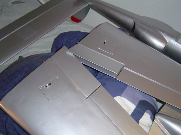

Flaps fully, and half way extended.

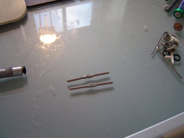

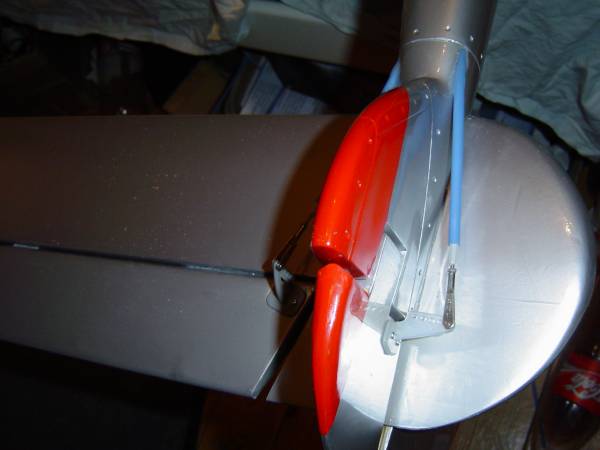

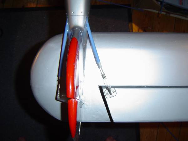

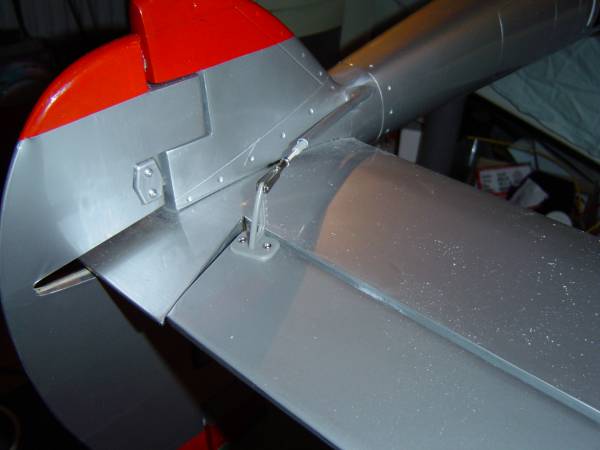

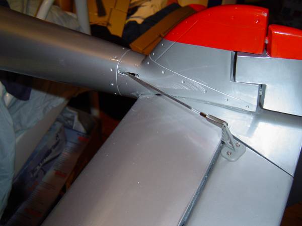

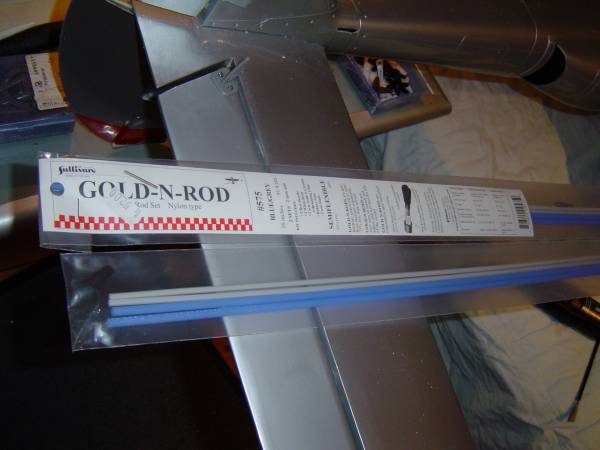

Installed the rudder and elevator pushrods..
First try did not work out, so I had to change it.
I initaialy used a carbon rod, with a steel wire, and clevis in each end, but there was just too much slop where the wire bends.
I was not satisfied.

So I bought some Sulivan Golden rods......that are now grey instead of yellow.

But the blue outer rods were straining my eyes......so I painted them silver [8D]
