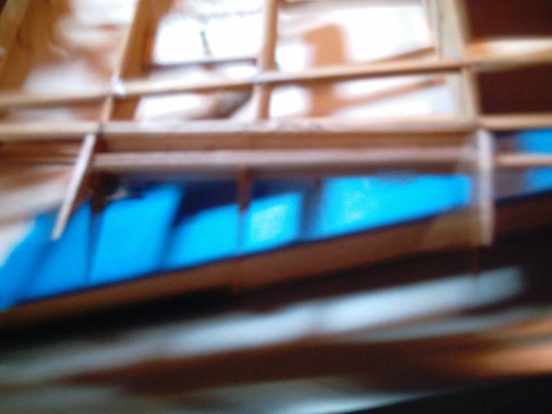

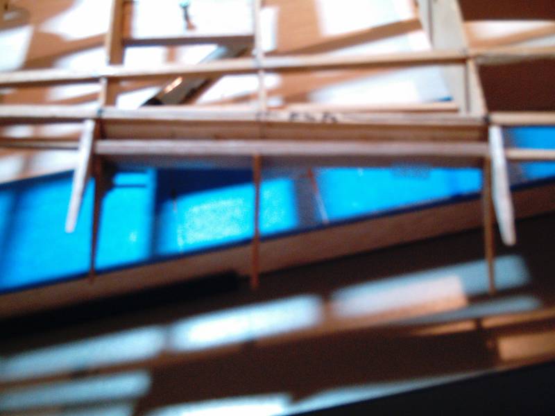

#34
Here are some crappy pictures of the Flaps. I decided to install them, though the plans do not really show the propper size or placement. I am kinda winging it.
nonetheless here are some pics......

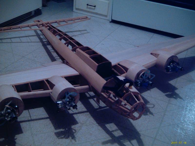

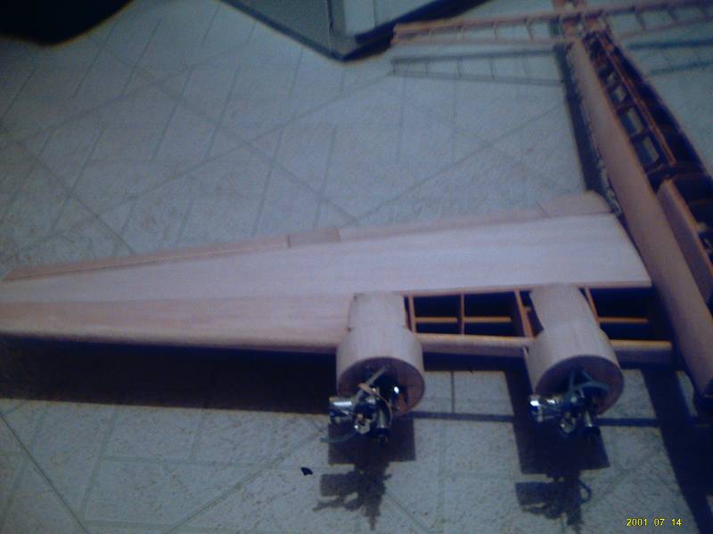

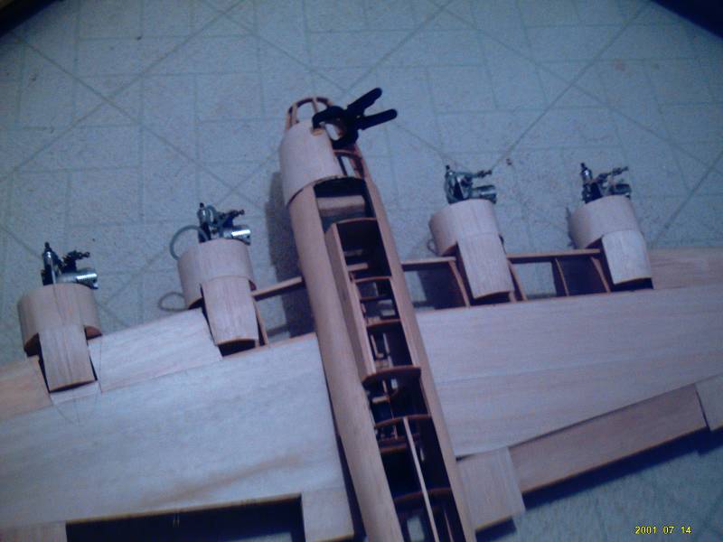

O.. I have started back on the B-17 with a fury. I am trying to take as much time as I can on each step to minimize mistakes. I have all the nacelles installed, retracts installed flaps installed, fuel tanks installed....... I sheeted the top of the wing, and now have to start shaping the blocks of wood to finish each nacelle and wing tips. I will hold offon sheeting the bottom of the wing for a while just to be sure everything is as perfect as I can get it. Right now I have switched my atention to the Stab and tail fin.
But here are some pics thus far.

Hi Prez! That plane is looking great... you're a very straight builder!!! I purchased one of these off of Ebay about a year ago that had been started... I'm having to "fix" alot of the original builder's mistakes however so it's slow going.
What size engines are you using on yours? Have you checked to see how the spun cowls will fit over them? Also are you using the standard muffler's or will you be putting pitts style mufflers on them?
I was going to put OS .25 SF engines in mine but, but there's just no way I can see to get them inside the spun cowls without butchering them. They're too long (from backplate to spinner nut) and the carb would partially stick out the front of the cowl.
I recently purchased an OS .15 FP and it looks like a much better fit inside of the cowling, but of course I now wonder if 4 .15's will be enough power to fly it. I'd prefer to use OS SF engines but it looks like OS only made them down to the .25 size... smaller engines became FP only. I have 2 of the .25 SF's here and now 1 of the .15 FP's.
I'm open to ideas about powering this thingy!
My wing is framed up and straight (after some rework of the braces in the center section... grrrr) but my fuse is twisted from the back of the wing saddle to the tail. I'm guessing I'll have to strip off all the sheeting from the wing saddle back, straighten the frame and then resheet it. How the orginal owner ever thought it'd fly with the tail some 25 degrees off from the wing is beyond me! LOL! I can't even figure how he got it so twisted to begin with honestly. But oh well....

HI,
Thank you for the compliment, it actually was a confidence booster, so thank you. I am using OS .19's... I actually am not using the spun aluminum cowl, but have purchased exact fiberglass replica's from a guy who makes them. I used one of his cowls onmy Royalkcorsair and it fitr perfectly. I have found that the fiberglass cowls give me a little wiggle room, and I am more comfortable cutting them.
As for making it an electric, this thought crossed my mind...ALOT, qand I think properly built would make a great electric, but I want to enter this into scale competition as a glow.
I have my kids down this weekend, so I probably won't get a lot done, but PROMISE to post pics of my progress. Thank you all for your support and honesty.

Regarding weight however, 4 micro-servos should weight about what 1 standard servo weighs... so not sure you're really saving anything there. I've decided to forgo the micro's and go ahead and put 3 standard servos in the center of the wing (aileron, throttle, flaps).
How'd you hook up your flaps? I'm thinking of doing them the same way Hanger 9 did my PTS Mustang, using trailing edge embedded aileron rods with a surface mounted servo in the back of the wing. I was looking at some scale drawings of the B17 and it appears to me that the optional flap-lines drawn on the plans are pretty much correct and to scale. Only thing I can see wrong is that there should be a very acute triangle of trailing edge material between ailerson and flap that doesn't move, dividing them.
On engine power, my plans list .15 to .20 as recomended engine sizes. But as you say, engine technology has increased horsepower per ci since this plane's plans were 1st laid out so today's .15 may be more powerful than the .20 of that period.
Did you get a scale cockpit interior for yours?
More pics as you have the time, please! I'll start doing the same.

Fyi: I took my fuse and wing with me to my club's flying field in Huffman, TX Sunday morning to solicit advice on how best to deal with the fuse twist problem.
To my suprise though, everybody told me to put the micro servos out in the wing and NOT to run cables to the center of the wing for control as per the plans. I wasn't aware that running cables and swivels would cause slop and flutter in the controls... of course, I've never done it that way before so I had no idea. In the past I've always used micro's embeded in the wing to control ailerons. Glad somebody stopped me from following the plans this time! 8-)
After alot of eyeballing it, the concensus was that I'd do best to peel the skin off the back half of the fuse and rebuild it straight. One or 2 guys thought it might could be soaked with water and alcohol and then twisted straight and put on a jig to dry for a few days, but that was going to introduce other problems apparently. So, I'll be ripping it apart shortly! I get to do my 1st rebuild on the plane before even having the chance to crash it. LMAO!
- Michael
