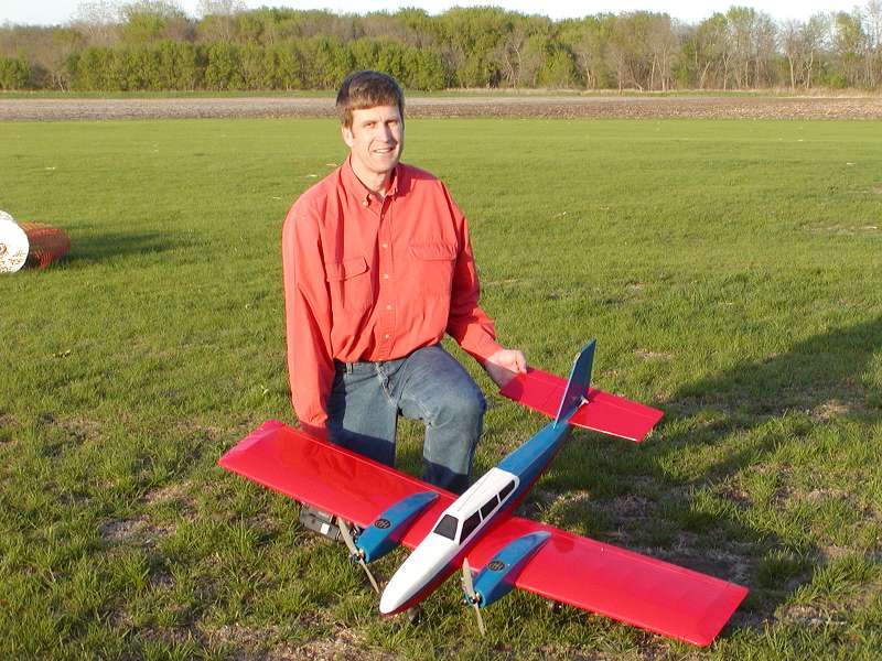

I've had my eye on the Great Planes Ultra Sport 40+ as a future twin project. Smooth pattern-like lines and the plans include a retract option.
I modified this Ringmaster from Model Airplane News plans for my 25s. Easy to build, constant-cord wing. 54" span, 39" length.

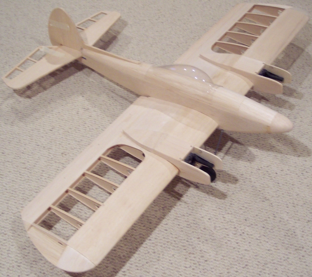

Since it is an "All Balsa" kit of simple design, it would be pretty easy to cut and build a Twin-Air .20 from plans. Maybe N.E. Aero would send you a set, or you could get a set from one of us who has built them. Of course, the parts wouldn't have the beautiful laser cuts their kits have, but it seems a shame to have two nice .25's and NOT put them in a Twin Air .20.

I took a Sportair 40 kit and put on two nacelles. Instant Twinair 25. Got the plans from Northeast Aero some time ago. Check with them to see if they still may have some in stock. It was a fairly easy bash. Best flying 25 size twin I ever owned.

Northeast Aerodynamics has the Twin-Air 20 plan set listed separately [link=http://www.ne-aero.com/specials.html]here[/link].
As nice as the 45 size, just smaller.

That's a great idea to get a Sport Air kit and bash it!
I vaguely remember when I built my first Twin Air a decade ago, someone said it was just a Sport Air 40 with two nacelles and a nose cone instead a firewall.

And the Twin-Air 45 is a modification of the Sport-Air 60.
