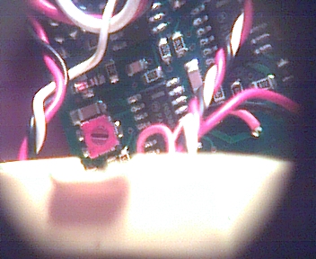

When you order the EMS/Jomar twin engine sync unit you get a small populated circuit board about 1 1/4" square, a box to put it in, two Hall effect sensors, four magnets, a hank of wire, and a little bit of wire solder.
You have to make 14 solder connections to the circuit board, and except for the sensor wires, you have to supply all the wire and connectors.
If you assemble it as indicated in the instructions, you can cut one leg of a long wye connector and hard wire the unit into the cut leg, then with the sensors hard wired to the board this is the least expensive way to set it up.

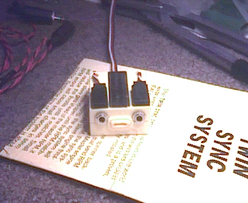

The airplane I got the unit for has plug in wings, so hard wiring was not an option. Went to Radio Shack and got two miniature stereo jacks and plugs, used these for the sensor connections. I glued two female servo connectors to the top of the box, the result is a fancy wye connector with places to plug the sensors in. See first picture.

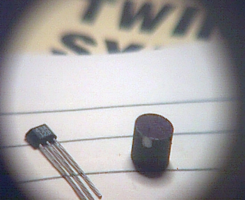

The second picture is one magnet, and the sensor. I had intended to put a size reference in, but forgot. The magnet is 1/4" diameter and 1/4" long. The sensor, as you see, is much smaller.

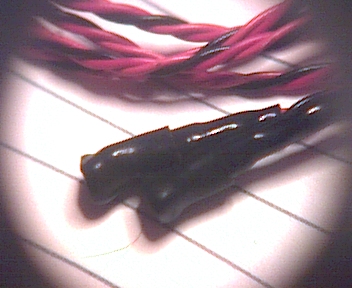

EMS suggests gluing the rpm sensors to the front of the engine mounting rail. I rejected that without much thought, the three tiny wires would be in the open, easily damaged. If the unit, operating normally, loses the rpm signal from the master engine it becomes a feed-through device, giving both engines the same servo signal. If the signal loss is from the slave engine though, the slave servo is driven to full throttle. This is not a good idea.
I soldered the leads to the sensors, then bent the leads to a right angle and potted the assemblies in a short length of shrink tube. If you do this be sure the flat side of the sensor without writing is on the outside.
Making up the sensors this way I only have to drill a hole in the cowl ring behind the spinner to mount them. The wiring is all reinforced, small chance of damage. See pictures.

PS: For a size reference, the lines in the first picture are 1/4" apart. Small stuff. wr.

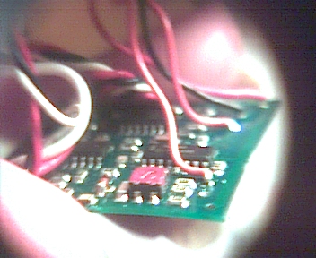

Here are two pictures of the inside of the box, as I said there are 12 soldered connections to make. Not difficult, the instructions are clear, but be careful.
If you do it as I did, three of the connections have two wires in them. THis is to have the master throttle servo plug into a jack on the box, if you suspect a problem the entire assembly can be replaced with a normal wye harness for testing.
Finally, a picture of the connectors on the box itself. Normal "J" connectors for the servos, the round jacks below are to plug the rpm sensors in.
