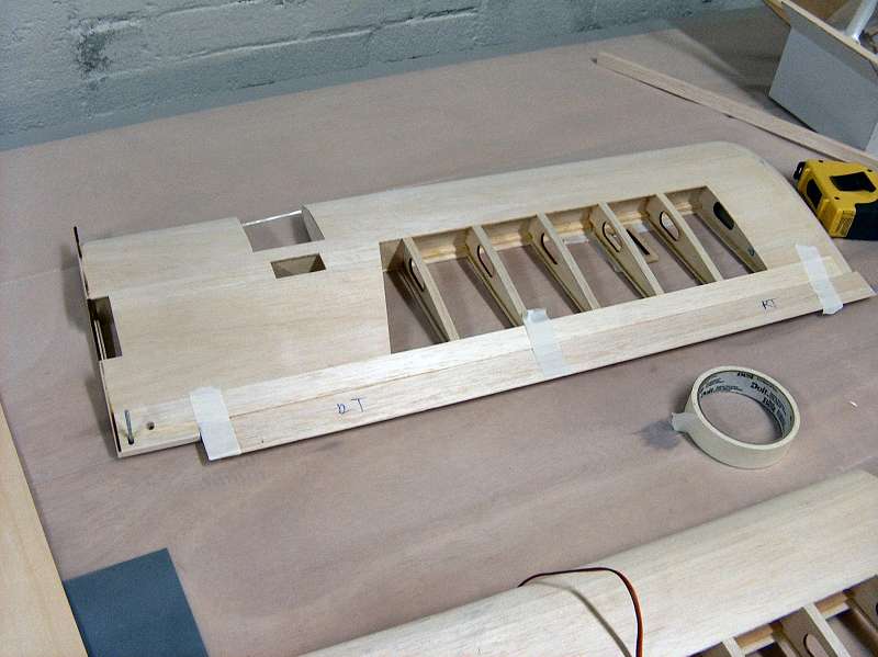

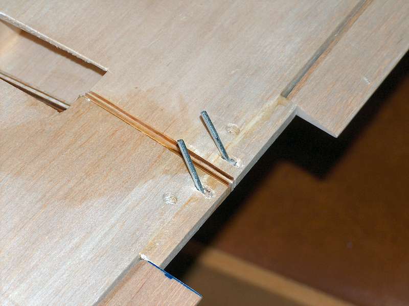

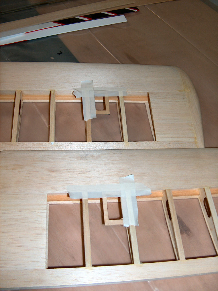

I finally got motivated today to work on the wing. While dry fitting a servo and servo tray to see if everything was OK, I notices that the tray was to short [:@]. The servo screws would have cut straight through the cross bracing (DOH!) So I had to make two new trays for the wings.

Here are the trays installed in the two wing halfs

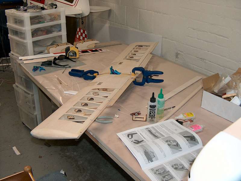

Default RE: Twinstar Wing modifications Thread
Here is the complete strip for the aileron and flap for one side of the wing. I haven't cut them yet because I am still trying to gauge where I should split the strip at. I am done for the day, will read up on installing Robart hinges and figure out where I want to cut the flaps and ailerons. I have also decided on Thunder Tiger Pro .36s to power this bird. That's all for now.

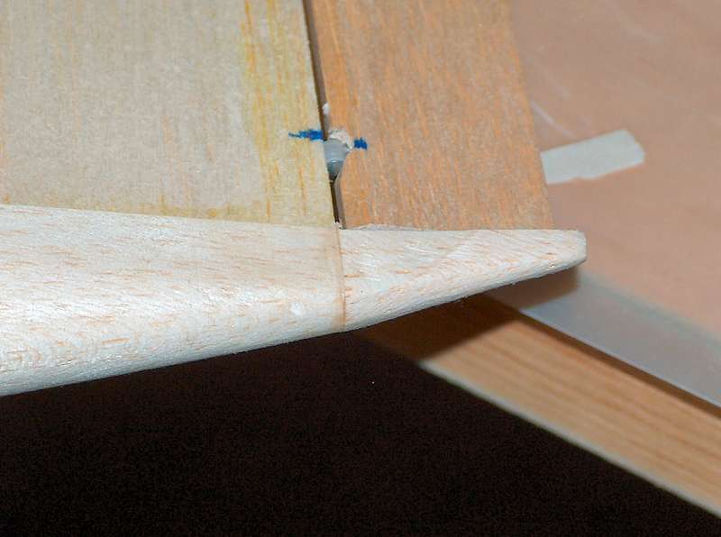

I have completed the left wing. Items completed Servo Tray, Flap installation and Aileron installation. I am using the existing Torque rods for the movement of the flaps. I haven't decided if I will use two little servos or fabricate an arm that will move both rods together. Here are pictures of the left wing. I have started on the right wing, but needed a break from working.
I am thinking about extending the wooden wing tips the lenght of the ailerons to have a little better air flow at the wingtips. Still thinking about that. The funny thing is this is a small little ARF and I am putting this much work into it.. I guess I can look at it like this. Someone else framed up my model and I am just finishing it properly

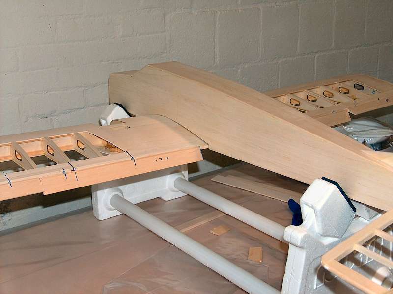

***********Wing Update*********

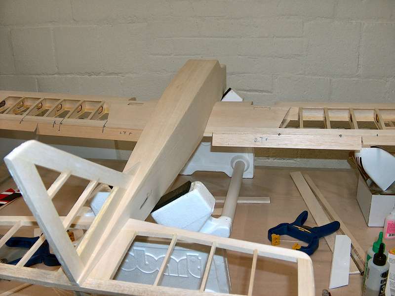

I have glued the two halves together after checking to see that the correct dihedral is there. I have clamped the two with heavy clamps and left them to set over night. I have also sanded the servo trays for a cleaner finish after the initial rough cut. I have also ordered two Thunder Tiger Pro .36 from my LHS. Thinking about using a combination of glass/paint and monokote to skin this bird. The glassing will make it easier to get the fuselage colors correct. Hope you guys are enjoying this thread.
Lee

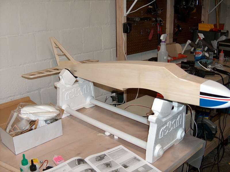

I have also finished stripping the fuse and tail section. I will be start that section tomorrow after the wing has time to dry overnight.

very nice pics! Have you considered installing clear lexan windows to make it even more scaleish!?

But to answer your question, I would love to have been able to do that. The problem is that the way the fuse is put together, all of the radio components are there. The plane isn't big enough to pull it off. I have also found out that I will have to do some modifcations to the torque rods since I dry fitted the wing today and the rods are hitting the back of the wing saddle. I may have to bend the rods forward and use a ball joint to get the throw that I need to deploy the flaps. There really isn't much extra space in that fuse. If there was a window for a cabin, I could see into the plane to find out what needs to be trimmed or sanded. I will look at it a little more tomorrow. Don't feel like messing with the plane tonight[sm=tired.gif].

I was able to bend the torque rods forward enought to get the amount of throw I was looking for in the flaps. I actually sanded some of the trailing edge portion of the fuse to see if the worked. Should have just bent the rods first. I will go back and use carbon fiber to restore any potential integrity that was lost due to my stupidness . My LHS said my motors should be in next week, so I am planning out my next move on this project. I need to review the instruction manual again to plan out those next moves. Project might be on hold for a few days until I get my engines.
