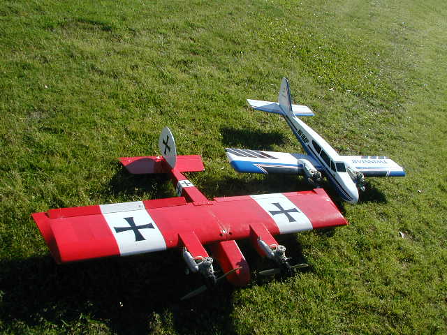

I got the opportunity to take a picture of Cedar Hobbies new plane with a Hobbico Twinstar to add to your information.
Have not flown the new one yet, but the ailerons are a much large size than the original. Should be fun.
Note from the pictures the difference in rudder and aileron surfaces.
Twinman
