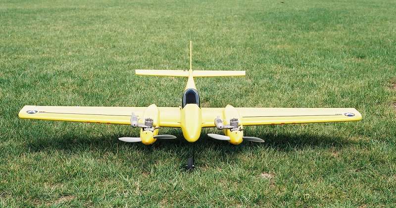

Check this picture, its a supersportster 40 twin, and it appears to be very easy to handle one 1 engine at 1/2 or less throttle (although, I broke it the first time it lost an engine, hehe)

I suspect Ed's 8 degrees looks just fine in the air. Obviously it works just fine too. I'm planning a twin Kaos after following Ed's reports. The results speak for themselves. Keep up the good work Ed! Mark
8 degrees does look like a lot, but first, it works and second, you lose very little forward thrust despite what you might think.
Do the math: Cos 8 = .99027. This means you are still getting over 99% of your forward thrust.
You don't notice it in the air. The first time you lose an engine and keep on doing acro and making turns both directions without rudder, you'll know what I mean.
I was flying my Twin-Air and doing a Cuban-8 about to roll upright on one of the down legs and an engine flamed out. As I rolled, the plane whipped off to one side. I immediately throttled to idle, leveled out and came up to half power. I put in the correct rudder and carefully landed. The Twin-Air has a big rudder, so there wasn't a problem holding it.

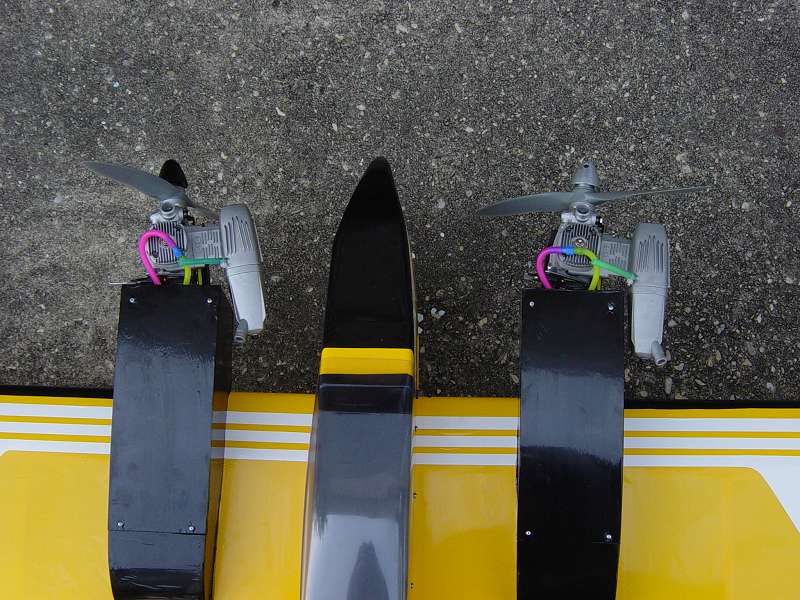

I bought a Goldberg Tiger 2 ARF and he installed 2 nacelles for 2 OS .46AX engines I had. We put in 8 degrees out thrust. The plane came out heavy, 9.5 lbs, but flew OK. After trimming and feeling it out, we started the testing.
I fueled 1 tank full and the other one only got 11 of 33 cranks of fuel. After take off, I started doing acro without regard to the engines. It's one thing to throttle back and shut one down, but another to have it happen unexpectedly. The engine quit and the plane hardly even yawed. I flew some more and tried some acro-rolls in both directions and loops. Loops were hard due to the weight of the plane, but everything else was fine. I made a normal pattern and landed. The next flight I switched tanks to partial fill and it worked out the same.

Well, so far I have some years of experience with my first scratch built plane, a Armstrong Withworth 38 "Whitley". It is by far not scale, but it flies still very well. It has a Wingspan of 1.80 meters, a weight of 4.5 kg, for the wing profile I used the NACA 2415 whitout washout which I think is always a good joice, and it is powered by two 30 year old O.S. .40 four stroke engines and with them it is hopelessly overpowered.
When I was up to build that bird I had a look on the Junkers Ju 52. The wing engines are mounted with an outward angle of about 5 degrees, so I just copied this. On my Whitley the engines pull 4 degrees outward. The point is that the left one turns at 9000 rpm, the right one, it is in a worse condition, only at about 7500 rpm. In fligt you don't feel any tendency of the plane not to fly straight forward!
So long I have 11 flameouts in my logbook, 8 on the right side and 3 on the left side, in various different situations. Exept when it happens at take off (all you need is speed......) it is quite easy to hold it straight with the rudder and a little aileron, no matter which engine stopped, but it is very importand not to use more than about 80% of power on the running engine. So far I had no problems turning on the dead engine, but I always try not to fly a too close curve.
