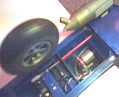

Anyone experimented with a single tank for two pumper carburators?
Bill

[b]BillS:
My "C-3/10" has a single tank, dual clunks, and a VP-30 pump on each engine. Works fine.
Here's the whole plane, and the pump in the right nacelle.
Bill.
ID:	320238   Click image for larger version

[b]BillS:
The C-3/10 has a pair of Magnum XL 46 engines, each with its own Perry VP-30 pump.
Most gasoline engines use the Walbro or similar carb, these have a fuel pump built into the carb.
Bill.
