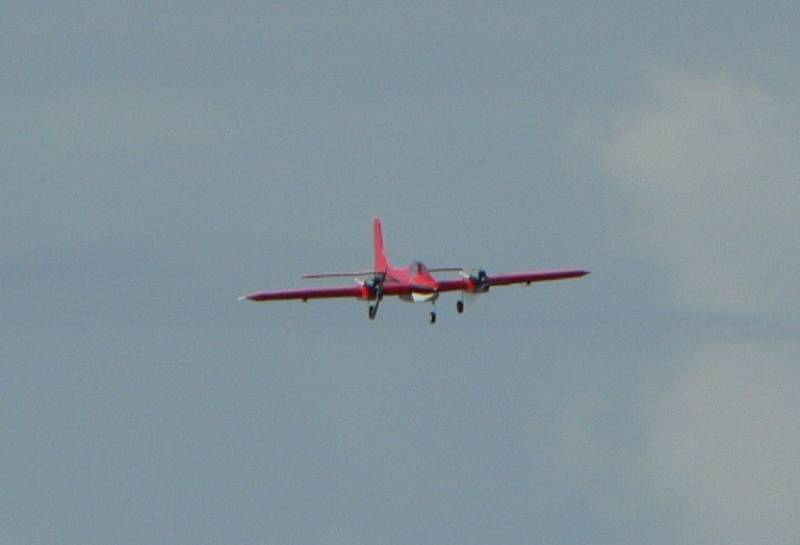

Cedar Hobbies Phoenix with 2 OS .65LA engines, 12-6 APC props.
Good flying twin. Nice straight take off. Very stable. Excellent handling. No bad habits. Good landing.
Only 1 flight as the connector to the throttle arm came off when I reduced to idle as I turned final. The carb rolled shut, killing the engine. I did not realize the engine had died until I saw it just before I touched down.
The LA .65s are good power. They ran well in flight until the connector came off. A pair of .91s would be better, but Flaps has my Saito .91s in a scale plane.
Next weekend I'll wring it out.

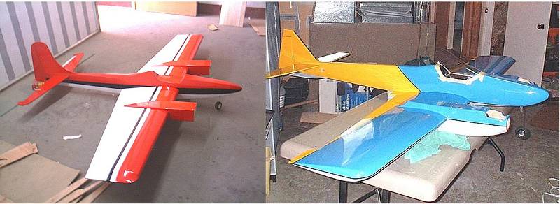

Roary:
This picture shows the prototype Phoenix on the left, and the Super Duellist 2/60 Mk II built by RCU member Blade47 on the right. B47 altered the shape of the nose a little bit, as drawn it would have been like the nose shown on the Phoenix.
The structure of these two planes is identical. If you build your nacelles and empennage to match, it will not merely look like the Super Duellist 2/60 Mk II, it will be one.

The biggest reason I ask about this, is because while I do have a few Duallists in kit form(not to mention a pile of other kits and plans) the arf bug has something of a narcotic effect on my building; it's too easy to get one of these things ready in two nights versus the weeks or months for a kit.
As I recall, the stock ARF fuel tanks are 8 ounce. The instructions mention some optional tanks by Graupner and I ordered them from Hobby Lobby. They have a double chin (as opposed to the single chin on DuBro & Hayes) and fit perfectly, getting 14 ounces in the same space.
