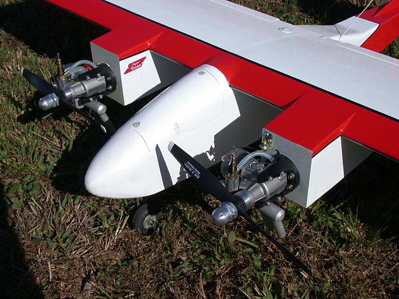

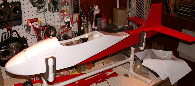

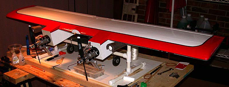

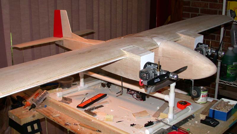

Hi everyone,
Rather than jump right into that Ziroli B-25 I thought I'd get some twin experience
I've built this RCM Twin Trainer from plans and I'm looking to see if she'll fly on Sunday. I have a bit left to do, final radio setup, final balance, and run the engines in. Everything looks good per the plans, wing incidence, thrust angles on the engines, weight...etc. I was planning on running 3-4 tanks through both engines tomorrow depending on how they break in.

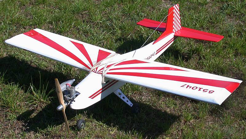

I've built and have been flying the single engine version so I think I have a feel for how the design will handle.
I'm interested in general advice anyone might have pre-first-twin-flight. (besides having plenty of help from the peanut gallery
Specs and Pics follow....(I'll post better pictures of the Twin after the first flight...my superstition...)
RCM Twin Trainer
62" wings
2 Super Tiger .45's on 10oz tanks
5 servos one for each engine on a "Y"
Weight about 7 - 7.5 lb

M:
The single locating peg for the LE of the wing is going to be trouble - any vibration at all and it will be ground away. I'm sure you can figure the result. It will be OK for a flight or two, but I'd replace it with a couple more screws as soon as possible.
Otherwise looks fine.
Keep your left thumb spring loaded to pull the throttles to idle, more damage caused by uneven power than by a complete dead stick in sport twins.
Enjoy it, and welcome to an entirely different world that's not really all that different.

Yeah, I did a little "engineering" on the wing attachment. The plans called for rubber bands like the single engine but I was worried about that arrangement. An I wanted something a little more precise in relation to the angles involved setting up the engines.
I'll keep an eye on it. Thanks!

When in doubt about an engine treat it like a dead stick. Minor damage from a dead stick can almost always be repaired. Must have had 200 engine outs over time and all were successful dead stick (1/4 throttle) landings with zero damage. Power is not your friend when an engine drops.

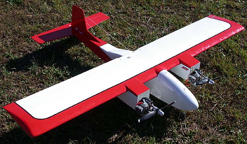

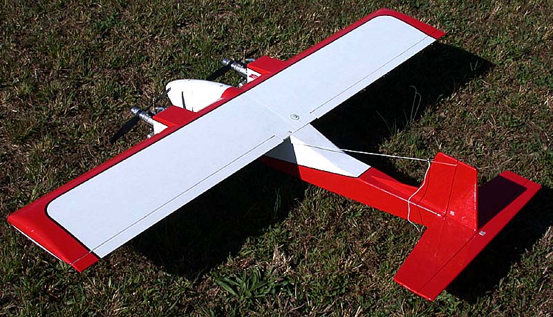

I had to push it back a week, but she flew! Man, what a cool sound with the two Super Tigers humming along! Lots of power too, she cruses along at 1/3 to 1/2 throttle nicely. I ran into a fellow club member with twin experience that helped me tweak the throttle linkages and get the low end together (and raise my confidence.) A few adjustments to the engine thrust and the wing incidence and she'll be flying straight as an arrow.
This is only my second plans built plane so now I have confidence that the first wasn't a fluke. Humm...what should I build next...
Here are some pics after the first flight.
