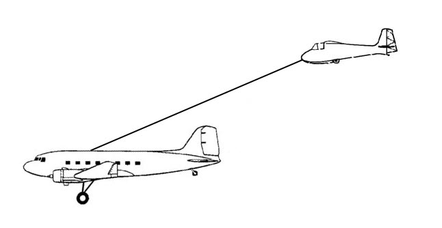

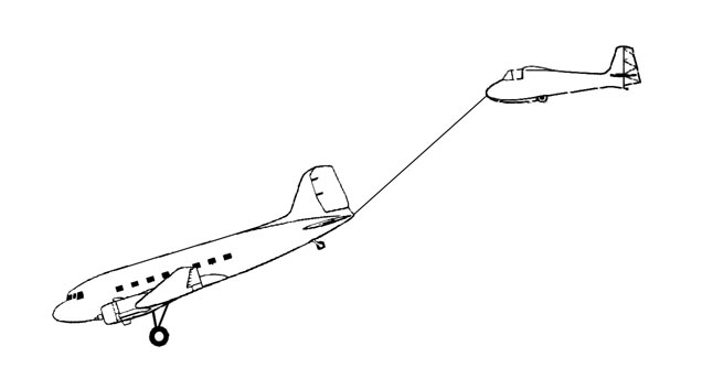

I can't comment on the engines, but I will throw in a comment on the glider....
Towing a glider can really be fun, BUT I would strongly recommend that you attach the glider's tow-line to the CG of the Tow Plane - not to the tail.
In full-scale glider flying, the first thing you are taught is to keep the glider down. You see, because the glider is a high-lift aircraft, the tow plane is pulling it faster than it wants to go. Therefore, the glider will rise faster than the tow plane.
Now think about it, you have a glider attached to a string, lifting up on the tail of a tow plane. Unless the glider pilot can keep the glider down, he's going to pull the tow plane's tail UP
Pull the tow plane's tail up, and the tow plane's nose goes DOWN, and once the tow plane has gone into a dive, it will pull the sailplane faster - creating MORE lift (See where this is going?) there's nothing the glider can do but go down with it (Or release - but this usually happens on, or shortly after take off, so there often isn't time).
If you attach the tow rope to the tow plane's CG, as the glider rises, it will just help to lift the tow plane.

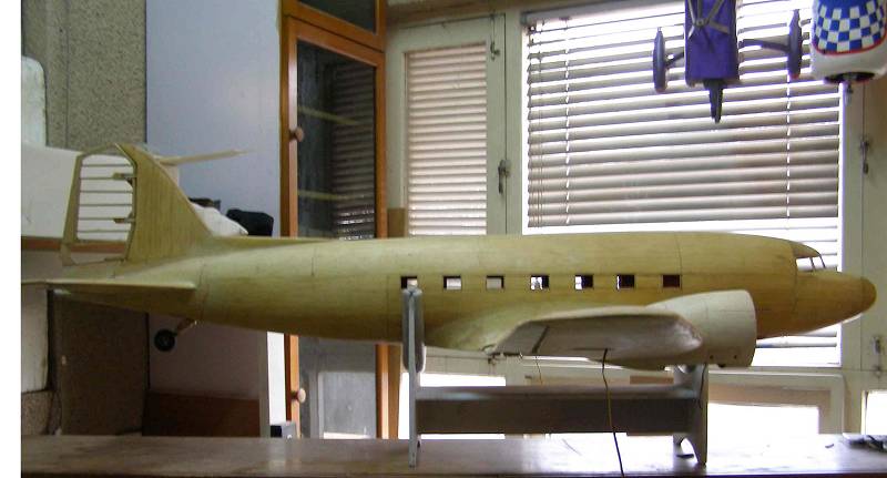

Hello,
Great to finally hear people who have actually got the Paris White DC-3 plan. I have been working on this project for quite some time now. Its almost ready and with some effort will probably fly in a month or so. Not a great plan to work with and very few details given in the accompanying literature. But it does give the CG location. I have bought two .51 ASP engines (2 stroke) for the bird. I did add an inch to the wing's center section so as to cater for a bigger prop (like an 11" or 12") which otherwise would cut into the fuse. I have also gone and made scale retracts that will be operated with springair retract mechanism. As for the fuel supply, i will install a 2oz hopper tank in the nacelle area fed by a main 12oz tank to be fitted on the center section (one for each engine). I will post some pics next time to let u guys see where the project stands as of now.

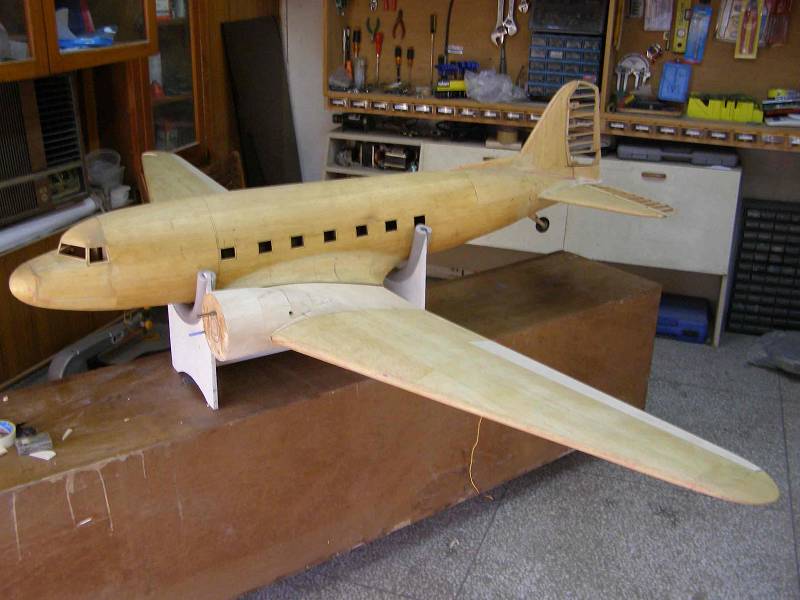

Hi Edwin,
I guess we should have the same plans. I got mine thru mail from MAN. It has two sheets. One with the fuse and wing layout, the other with all the formers, ribs, nacelle, and tail section detail. On the page with the fuse layout, they have marked the CG with a typical circular CG logo on side view of the nacelle and wing area shown below the fuse. The root chord is around 355mm and measured from the leading edge the CG spot is exactly 135mm. Let me know if that is correct.

I got the plans way back in 1998. I suppose some details just faded away on the master copy till they send it to you guys .
Mark you are right about the R13 rib for the rudder. It is exactly the part you guessed on the plan. Don't give up on the plans. I'll be happy to help you out with any missing info or other details you would want when making the plane. The ronson can fuel tank kept me bogged down for quite a while, 'cause it wasn't available here and the thought of permanently sealing a custom made tank inside the nacelle was too unsettling for me. Eventually I have altered the wing design so that the outer panels are removable from the center section and the hopper tanks inside the nacelle area are accessible for maintenance from the end ribs of the center section.
The all up weigth for my machine is going to be in the 12lbs range, owing to heavier scale-looking retracts, 9 servos (2 aileron, 2 throttle, 2 flaps, 1 retract, 1 rudder, 1 elevator). I think two .51s would give me the leverage to not worry about being short on power if other fun stuff needs to be added (like the paratrooper dropping thing). Also I have a feelilng that the whole thing will come out tail heavy and I would rather have heavier engines up front than some dead weight in the nose.
