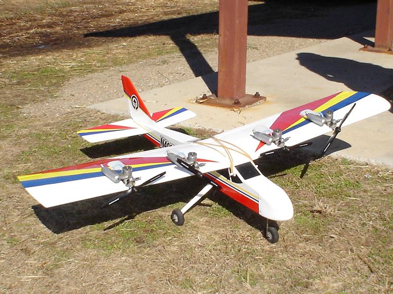

Sig Four Star 60 with 4 OS 25 engines.
Hey Wayne 22, what servos would you run in the wing of the four star 60 for throttles? After reading up on some of these so called mini servos I agree that this type of servo is not what what I am looking for. I have no intention of putting this aircraft in the ground just to save a few bucks or a few grams of weight.
I am sure the servos will not be the only obstacle that I run into. I am also sure that out of all the rc people who are now reading this could have an enormous amount of ideas to share with me. I have a basic idea of what I am going to do right down to the nacelle design. But nothing is written in stone. How about some of you super smart rc people jumping in to share some of your ideas so we end up with a successful build.

Sig Four Star 60 with 4 Os 25 engines.
Hello Wayne, I ordered the Four Star 60 today. I decided to use the S3151 servos for all functions.
So once I get over the fun of diving into a new kit I will go to work.
The first thing I’m going to do is build a prototype of the nacelle.
I need to fit a Du Bro 6 OZ fuel tank and a Hayes AL25 engine mount into it.
I plan on duplicating enough parts to construct a short mock up of the wing.
Where the nacelle slides into the leading edge I plan on doubling up at least 2 ribs with 1/16 plywood. I figure that will also provide a strong base to install the servo mounts. I am going to sheet the wing with 3/32 medium balsa from the leading edge back to the main spar both top and bottom.
I may have to add a couple of ribs to the wing so I can position the nacelles as close to the fuselage as possible.
I hope this thing gets off the ground.

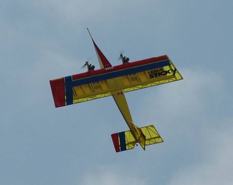

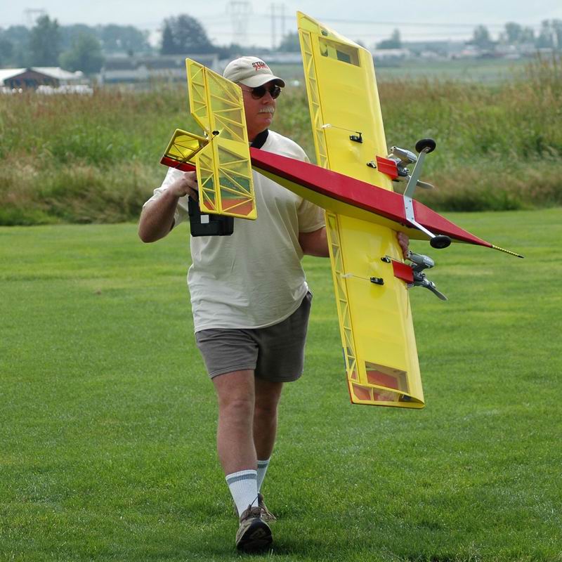

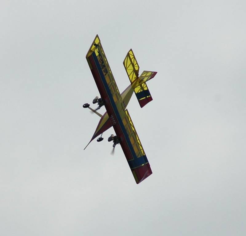

I have had great success with this setup.......Ultra Stick 60 platform-
-Twin OS 46Ax's
-8 oz. slimline fuel tanks
-3004 futaba...ailerons & elevater
-s9203 futaba or better rudder
-(2) HS 81 for the throttles
This was a great kit to modify...the wing has lots of room to conceal the tanks & add the throttle servos.
It flew great for over 2 years until last weekend... I was doing full throttle low level loops & could not pull out in time....It would hover rock solid(unable to torque roll it), unlimited vertical & a blender that would go into a blurr.
I will probaly buy another one to modify...maybe this time I will make it a triple just to change it up alittle.....0 thrust angles, if I flamed out I would kill the other engine & float in from almost anywhere...It flew on one engine but was a hand full to get turned around...it was easier to just dead stick it in....I'm going to miss "Ultra Sticky"

Sorry for the loss of a cool plane. You would think with that pointy nose it would have made a better "Yard Dart"!
A triple would have to have awesome power.....go for it!
