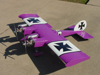

This is my new twin.
Hey Twinman.........You recognize this
2 Tower .75's
APC 11x6 4 Blade Props
Modified Super Stick arf
The engines have been run-in but no maiden yet....2 windy.
Will try again next weekend

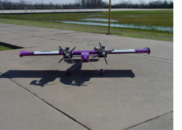

and another view......

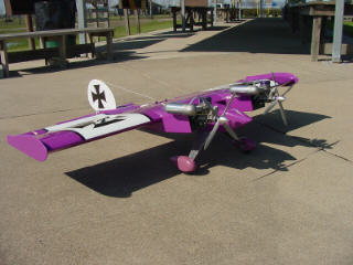

and finally.........

For the rest of you, this is the work horse for most of my experiments with twins and gryos as seen in these posts and the techniques section at our sister at rcwarbirds.com about flying twins. In that series of stories I wrote about using two gyros to do a single engine take off......this is the plane!!! I can only assume the new owner will also honor us with a single engine take off!!!!!!! maybe????
It is a converted hanger nine ugly stick 60, eight more inches of wing span, and wing plates to reduce the wing loading and make knife edge easier. The wing has full length carbon fiber strips and wood between the spars to increase strength.
If Robb is honest,,,,,,it also has a hidden extra fire wall in the nose for a .25 size engine.
