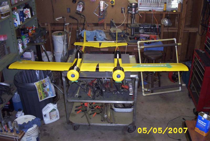

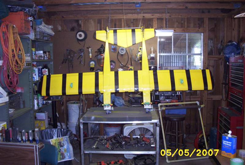

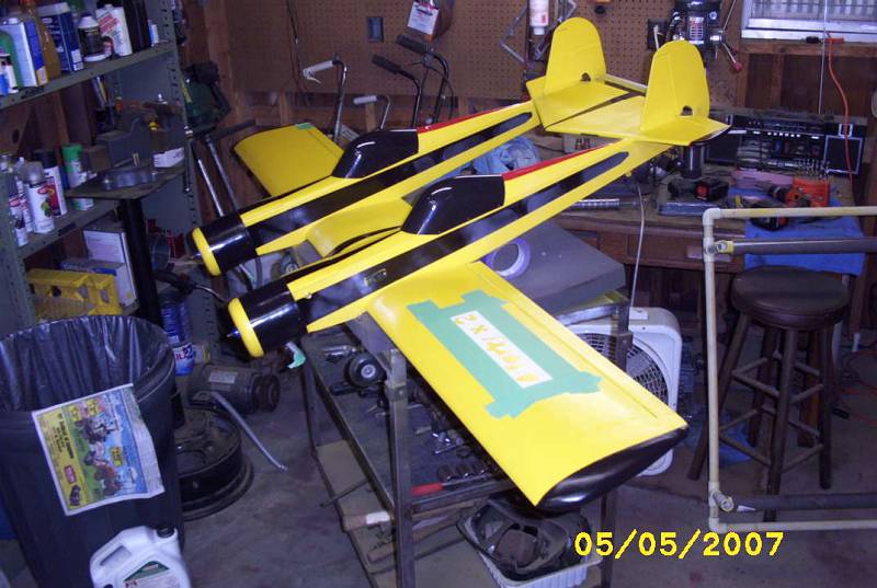

I suggest you do something like this. See picture attached. I have a twin made out of 2 Four* Forty's, running Evolution 46"s with 10 x 6 MAS props. I hope to maiden in July. Still putting the final touches on it.

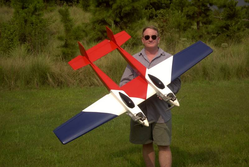

Jim, nice plane....

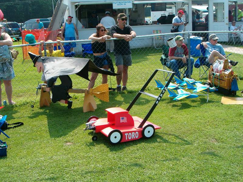

How about flying 4 at once? Have you seen this? It is actually one plane made of 4 small ones connected by dowels, Front plane has engine, L&R are ailerons, and rear has the elevators. In flight it looks like a formation, rolls loops etc... look cool. It belongs to a guy in aneighboring club who also has the other oddities pictured here.

Yes but it only has one motor.... there for not a twin or a quad...

Very true, but I was just pointing it out from the formation flying comment.

Evan: Great looking plane. I really like your color scheme. Give us some specs on it, type, etc. and have you flown it yet?

I built it from two Tower kaos 40 kits. Alot of modifying other then combining them to make them look like the old Bridi kaos's. Any way they have old OS .46 SF's one counterrotating, one normal. One set of radio gear in each fuse (one aileron, elevator, rudder, and throttle servos and battery switch reciever in each fuse). Flys excellent. It's 7, 8, or so years old and has hundreds of flights on it.

I always kind of wanted to double up two Four Star .40's or .60's like that.
Never did it though.

Ok, looking a bit closer, I see you have ROUND cowels on those four stars.
That's different. Are they home-jobbers?
And how did you decide on the amount of "middle wing" to leave in there?
Did you let the tail surface dictate that?
