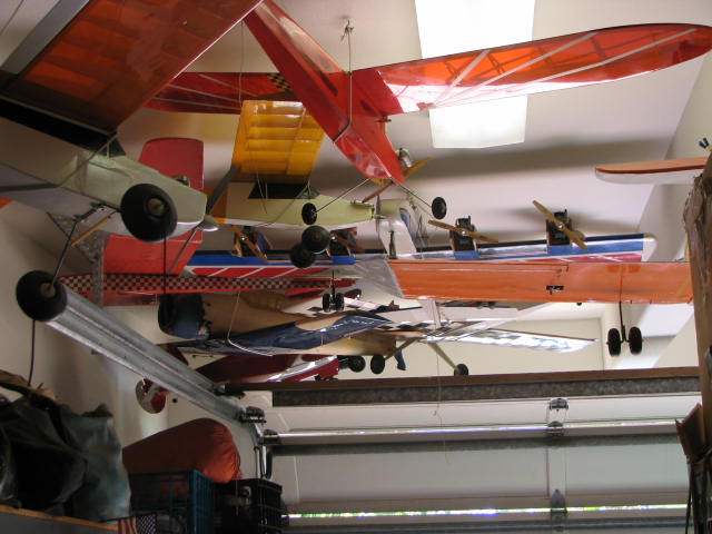

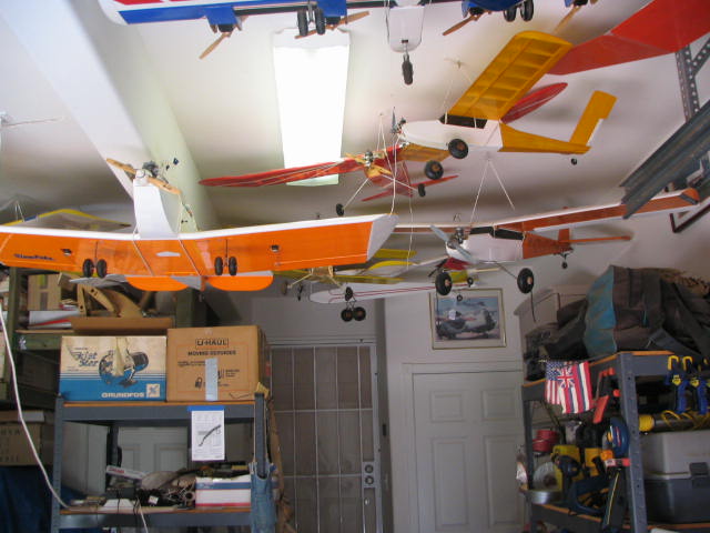

Nice hanger. My planes lean on the wall. It works for now.
