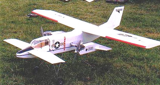

yeh, i think i forgot to mention this but its actually built so i can take off like a normal plane, i have a high U/C so i can have space for the props, thats one of the main things i was considering when building it. If i ever get an engine failure then i've got a lot of things in my favour, 1st being i can land normally, 2nd those control vanes will give me extremely good control on the roll rate if need be so i should be able to hold it off on a little engine throttle for the engine thats still active, if you think about it, its a 5.5lb plane and has a total of 12lb static thrust so i've got plenty of power if need be. So if i ever have a deadstick then i should be able to bring it down safely with some good piloting, hopefully
Also on the cross drive system and the heli setup. At the moment i don't have either money or or room for either of these so unfortunatly i'm gonna have to be out on these for the moment.
I've included a picture of what mine roughly looks like, this picture is Don's first design which i have copied from him,

I noted that you said use a gyro on the "Other engine".When I did my experiments, and the post is "Hovering with a twin", I think in page two now. The gyro I used was for two channel ailerons, except here I used it for the two channels to the throttles that were slaved together. It really did help. The problem I was trying to aid, was that with a conventional single tail plane, there was not enough prop blast for the rudder to work, and using the gyro on the two engines really did help. Completely successful for hands free hover, no. It is possible to keep the gryo on for normal take off. I used the hobbico aero for my experiments.

ok thanks again for the info. I've included below a diagram of my radio gear, i think everything is ok on it apart from the gyro setup which i'll have to revise. I'm on mode 2 so ya know what is what with the reciever channels ect.
I think with the way it is that i shouldnt need to turn off any gyros in plane mode. In plane mode i have the canard and the control vanes controlling pitch. The engine speeds and ailerons controlling roll, with optional roll control from vanes if i need it. Throttle is just both engine speeds again. I have no rudder control which just made things a bit easier for me and its not really neccasary in my opinion anyway.
My rotation mechanism too, is a modified servo. I've wired the pot. so its outside of the servo and replaced the servo motor with a 280. If you can sort of imagine the motor driving a leadscrew (spur gear) which moves an long nut back and forth. This then is attached to the rotation arm to pivot it back and forth. At the other end the pot. will be connected up so it'll be caliberated correctly so i should get the exact amount of movment that i need by operating a rotary switch.

What you have there is totally unlike what I had pictured in my mind. But while it looks like a lot of my cautions are negated by the design, I still have the feeling that a hover would be like balancing a needle on the point of a pin.
Your vectored thrust, I think, would allow extremely slow flight, but you'd still need the aerodynamic surfaces for attitude control. And since they did not show up in the picture, at least in a way I could understand, perhaps the "Vanes" you mention would be serving that purpose.
Maybe some pictures so we Yanks can see what you're doing?

apparantly Don Incoll's one had to be held by the rudder slightly in the hover but i think he experimented several times letting it go and having a little heli flight with it and it usually turned out okay. I think he was always quite cautionary about one of his engines failing so he didnt like to hover around much. The main reasons i built one was to explore something comlicated and try and make a cheap heli basically. I think so far the whole project has cost me about £270 approximatly which is about $460 i think, probaly a little less.
I dont know what prices of heli's are other there but if you add the price of a transmitter to mine then to kit yourself out with it will be about £320 in total, for heli's like that in britain will set you back usually at least £500, sometimes a lot more.
Considering that, and the fact it can transtion, as long as it works then i've made a very cheap basic heli and a plane. Someone who i know has said that if it flies like a heli and can do everything as planned then i should approach some manufacturers about making it into a kit. Don't think it would ever get that far but it'd be pretty good if it did
I've been making a site for my VTOL (called VeeTol, pretty cheezy i know) and that will have a lot of pics then so hoefully in about 2 weeks time i'll have a lot of pics on the net for everyone to have a look at, and a pic of it either flying or in a thousand different bits
For the first test flights i'm going to have it securely bolted to the ground and give it about an inch of movement with fishing line or something. First thing i'm lookin for is to make sure it does have enough thrust to get off the floor! As long as that bit goes okay then i'll gradualy let out an inch at a time until i can get an idea of how unstable she is and find someway of correcting it.
