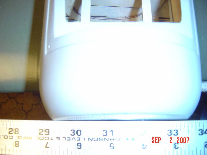

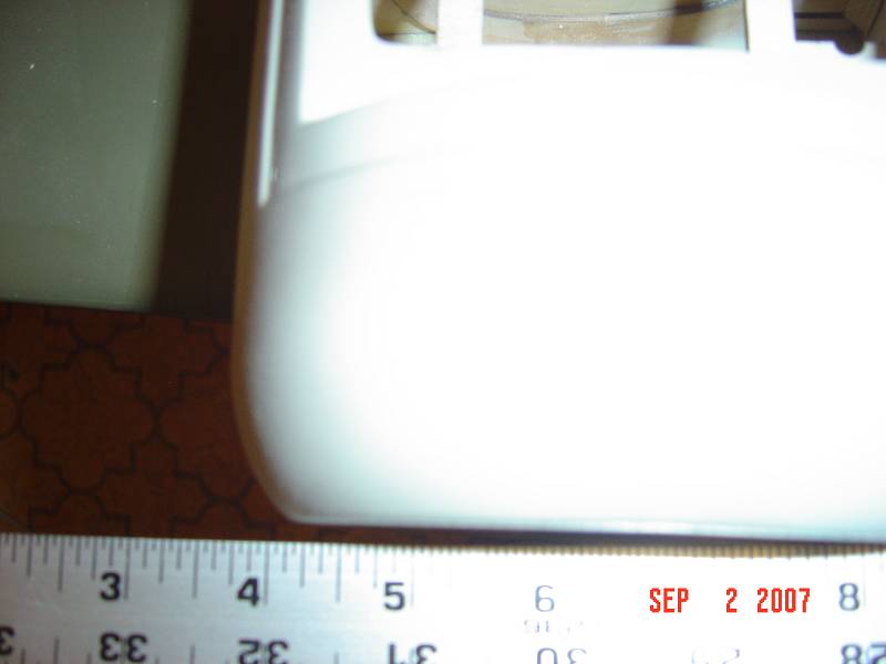

Should the firewalls on each nocel be parralell with each other?
And should the firewalls have the same incidence?
If so I have some fixing to do.
Thank youall for your help
God knows I need it.

not neccasarily,most twins have out thrust and down thrust built in to make it easier to fly lon lone engine.amount varies with manufacturer and design.

THanks aerowolf
I guess I'll just finish puting it together and see what happens.
I have been sitthing on this plane for quiet a while not sure what to do about the alingment.
THe firewalls don't show the same incidence either.
