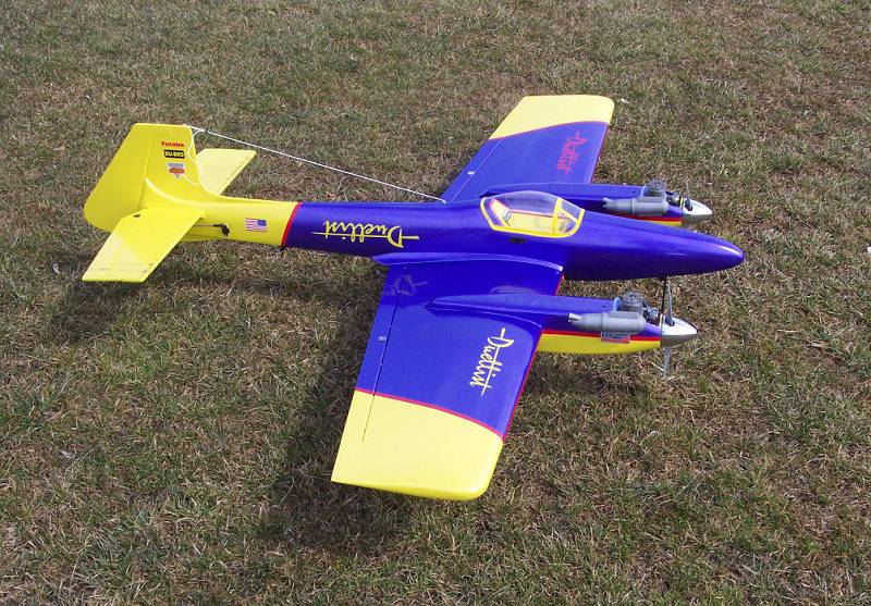

I built a Pica Duellist which I think has 2+ on the wing and stab but made the engines 0 to the wing cord and it flew just fine.
Here's a pic of my current Duelly that was built from the Mk II plans.
