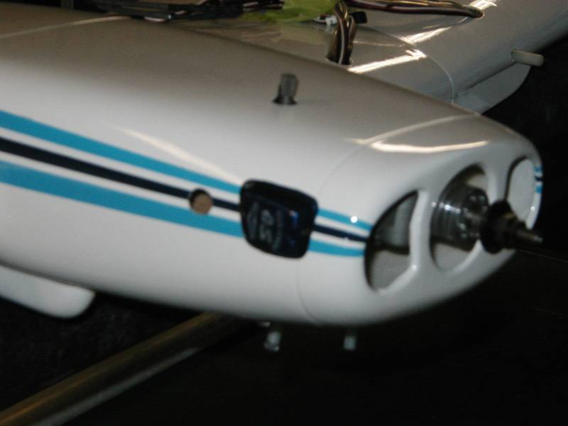

Not OS FS52, but YS FZ63S I plan to use for TF310.
This is the nacelle view of the left wing. The extrusion of the tappet cover on right
nacelle is a bit different due to different thrust angle.
I will use a scale muffler from Hattori(not yet installed). Just for reffernce.
The reason I chose YS was it's size( smaller than OS FS70), yet has enough power
and reliability.

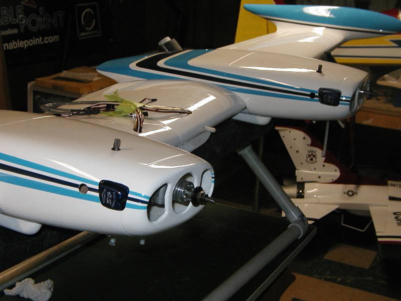

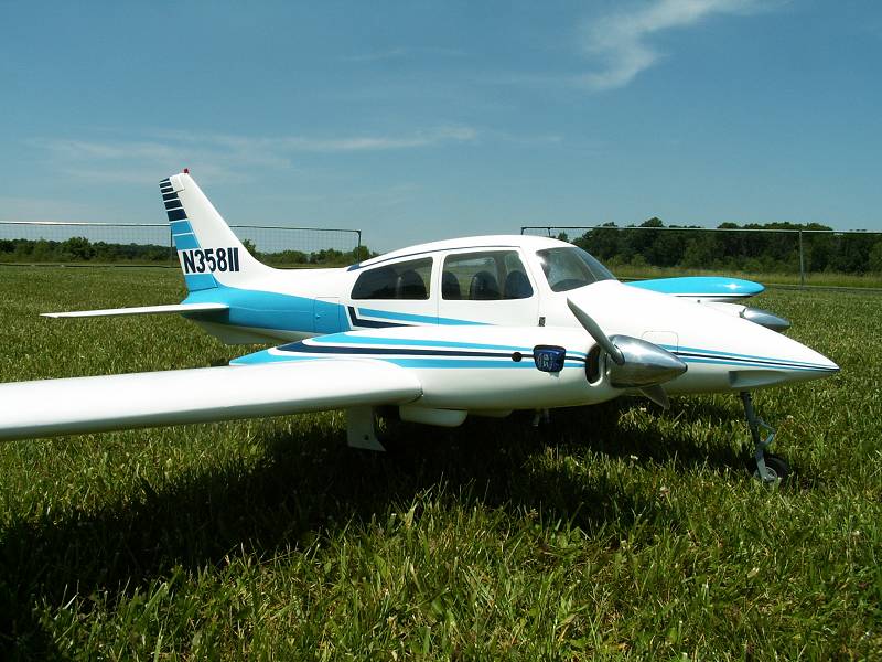

Here's mine with OS70 ultimates. Good power.

Thanks for the Photographs. I'm also considering RCV-CD-58"s. I had not thought about YS but will surely consider. I have a YS110 on my TFP40 and am extremely satified with the power. I was concerned with cutting the nacells but yours look pretty neat. Thanks again.
