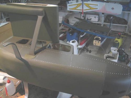

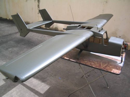

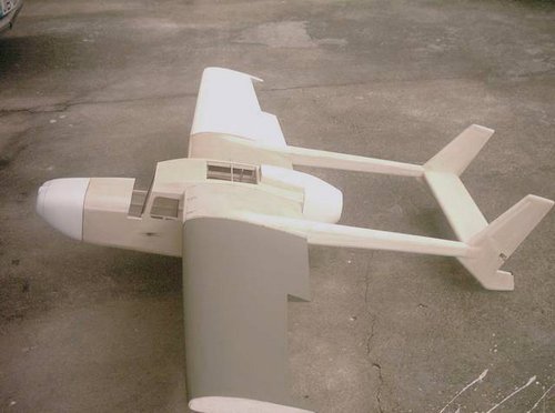

I was talking exactly of the engine angular offset. A little to one side and a little down.
The engines are allready isntalled and they are both at 0º. Hope this will work fine.
Here are some pics. I willl take a few more now, with the lights and engines installed.
The test flight will be tomorow... If all works fine, then it will be time to paint and add interiors and antennas, and all the scale details.
Hope you like it!

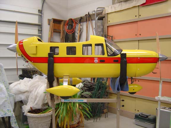

As long as we are talking about Skymasters, here is a couple pic's of my Hostetler 337. I am jus finishing up with the trim on the midsection and wings. Using two DA-50's........
