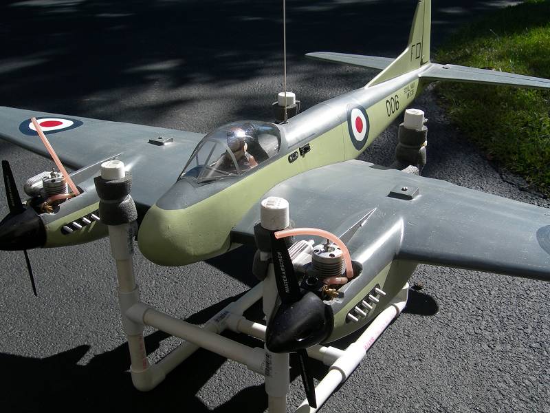

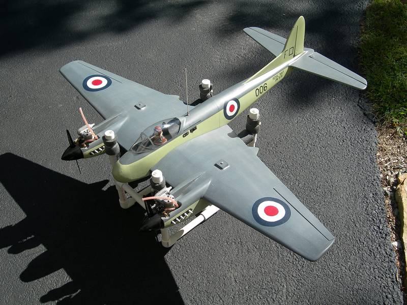

I've been happy with the little DH Sea Hornet I scratch built from UK Plans by Gordon Whitehead. It has a pair of HB 15's in it. It has a flat bottom wing and easily lands on the 2 nacelles.

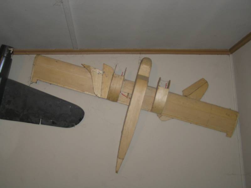

If you want something different and scratch built, I have a 1/12 scale Grumman XF5F that I designed a few years ago for 2 Norvel .074's, which put out a lot more power than their displacement would suggest. It would be a screamer as is but may work better for you scaled up a little. It is 44.5" and 44 ozs as built. Flew great. One of the engines needs replaceing and Norvel went out of business. So now it hangs on the wall awaiting a possible switch to the E word.
Here's a link to its thread http://www.rcuniverse.com/forum/m_39...tm.htm#3945868
Ben

Looks like the internet ate my picture. Heres another one.
That is a nice looking Sea Hornet.
Ben

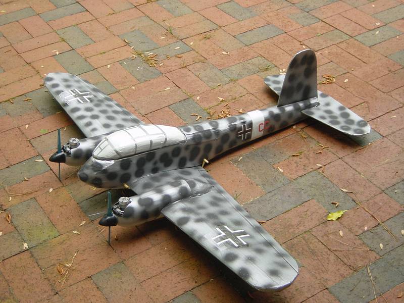

Grab some styrofoam and start cutting. Then some corregated plastic for tail fins. Some packing tape and rattle cans. One weekend and you are ready to tie a streamer on it...
