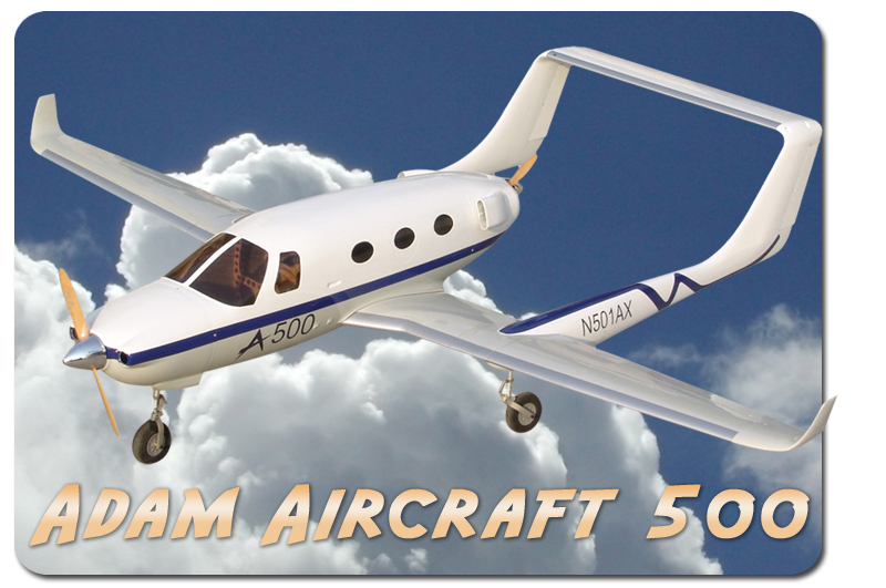

Hi All..
Am planning my build of the KMP Adam A500, my first twin. Am setting it up w/ electric motors, and have a couple questions I can't seen to find answers for via forum search.
This is a push-pull configuration. I'm assuming that no thrust needs to be set, just use whatever is given on the firewall?
Now to the part that confuses me 2 motors out of the box, typically rotate clockwise, as seen from behind the prop, according to how the leads are plugged on a typical single setup. This is fine, since one in front and rear, that would seem to offset torque. A pusher prop would seem to push the air out in this case, as IF the motor was ran reversed? Is that correct? If you ran one motor reversed, that would put all the torque to one side, correct? It would seem easy to want to reverse the rear motor and run a standard prop, but am thinking that again, both motors would therefore turn the same direction hence too much torque?
If someone can set me straight on push-pull, it would be appreciated!

BTW, sharp looking plane!

One of the primary reasons of having a pushme pullyou configuration is that the torque from each motor cancels out the torque from the other making for much better handling qualities. If the rear motor is reversed (and a tractor prop used) the torque will be additive resulting in an increased yaw tendancy to the left. Since you don't have a rudder in the slipstream, it may cause handling problems at low speeds. Pusher props are very much available from Zinger, Master airscrew, APC and Graupner. Pusher props for electrics, thought, are pretty rare..... but there is law saying that yoiu have to use electric props...FWIW.

Hey Guys.. thanks for the info. From what I'm reading, since there are several pusher props available for electric, it shouldn't be too difficult to finish with a setup that cancels torque and pushes it throught the air as designed.
Boomerang1, the pic does very little justice to the kit. A far better representation can be seen in the June Model Airplane News. It would have been the cats meow to have been able to get one unpainted. Since its my first scale project, I'm in the process of taking it down to the primer, for a final pearl white paintjob that will reflect Adams N501AX, #C0002. Man.. you talk about some work.. it'll take me 3 months or better just to get that much done! But.. may as well take time and do it right... we'll see just how sturdy the Black and Decker Mouse sander is!
